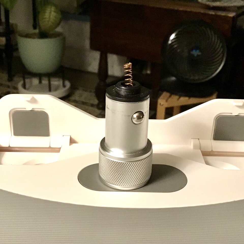

    I’m sorry this is so mundane but I did several searches using different phrases, with no results. The problem is in the title. IMG_1858.jpeg
    I need to know first and foremost if it’s safe to poke inside the lighter opening with something metal, or if I’ll give myself a shock or even damage something.
    I have a metal tweezer and a couple of metal medical clamps that might work. One is short with a curved tip, and the other is long and thicker with a straight tip. This is my last request tonight for info, and I do look forward to the answers. Thank you!

    Yes it's safe... There might be some tiny sparks you can avoid by making sure the vehicle is turned off. And if you can't get it out head to a local wrecking yard and pull one off a wrecked Prius, they're easy to remove.
    Also what's that photo of? It doesn't look like anything I've seen inside of a gen2 Prius?

    Should be majority plastic drill into it 1/4 inch or so a lil hook from awl set .yes reach in you could never get hurt it's a tool going in not skin.
  5. Mendel Leisk
    59,474
    40,918
    Concur, incomprehensible pic of the day.

    That's the charger the dude pulled out of his cigarette lighter receptacle hopefuly the under dash . This is a charger he pulled out you see it's not complete it's Missing the side grabbing metal and the positive center piece usually blk plastic. because it's not part of a Prius
  7. ChapmanF
    26,963
    17,689
    The side grabbing metal is a ball in this version. Looks like it's still there. The positive tip that unscrews for access to the fuse, that's missing. So is the fuse. I'd try to use the tweezers to pull those out of the Prius socket.
    Maybe the tip wasn't completely screwed on, last time this got plugged in.
