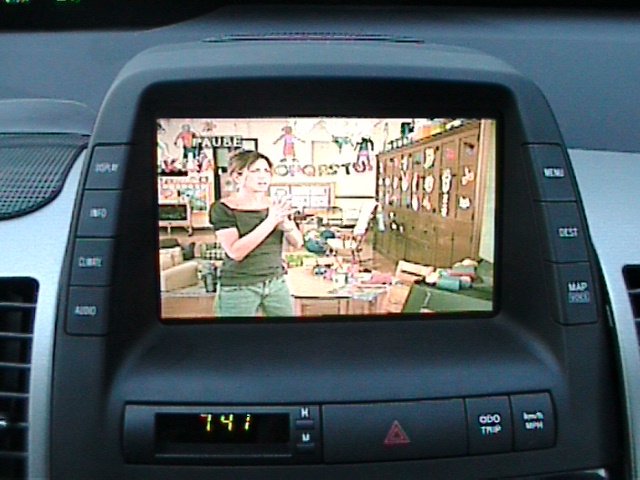

  16. ScubaX
    ScubaX Member
    Mar 29, 2005
    484
    Redding, CA
    This is what it would look like:
  17. Tigerops
    Tigerops New Member
    Sep 28, 2005
    84
    That's not bad at all! Maybe someone will make an interface that controls the iPod while allowing it to play video WITHOUT having to spend $600 like the AVIC.
