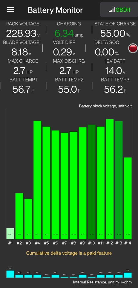

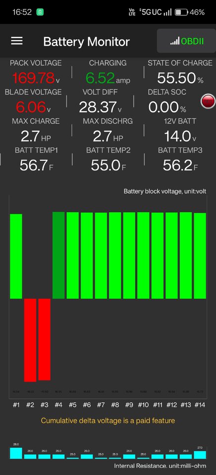

    That's a bummer to hear. I got my obdII monitor and ran it in the Dr Prius app. Below are some photos of what it looks like. It does look like the hybrid battery is going unfortunately. Sad times =(

    Jan 9, 2026
    Actually, after looking a little deeper on here, i stumbled upon some posts that had negative voltage results like mine in the Dr Prius app. It appears that a negative voltage reading means there is a failure in the voltage sensor harness or there is corrosion on the pins in the ecu socket (inside the HV battery) where that harness plugs into. Does that sound reasonable to you and maybe that could be the culprit instead of the HV Battery itself going bad? I've attached a picture of what the reading says at first before the bars go negative.

  6. bisco
    114,905
    52,544
    yes, corrosion is quite common. clean everything up and replace the harness. you might get lucky.
    all the best!
    priumium likes this.
  7. Hayslayer
    Hayslayer Active Member
    Nov 6, 2024
    492
    283
    Yes, it's much more likely the battery ecu has corrosion on the socket pins. Will still probably need a replacement ecu (ebay for a 100 or so) and it's best to install a new harness (about 60 bucks)
    Brian1954 likes this.
