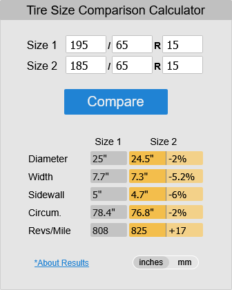

    they should fit, but your speedometer will be showing that your moving faster than your actually traveling. Your losing 0.5 inch diameter so speedometer that's reading 50mph, your actual speed will be 49mph.

    From the above revs/miles info, yes, it’ll make the car think it’s going roughly 2% slower.
    just for the record: with the stock tires, if speedometer displays 50 mph the car will actually be going ~49 mph, by design, in accordance with various regulations, the intention being to ensure speed is never underreported.
    besides the speedometer impact, the odometer, which is typically quite accurate, will also be misled, accumulating miles ~2% faster than actual.
    Another change, not a benefit with snow: you’ll have lowered the car roughly 1/4”.
