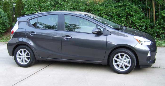

    I got them as an option for my Three, and they look like this:

    Okay, I see. They also look like the 16 inch rims that are offered on the C 4. Didn't know they had the 15 inch version.
