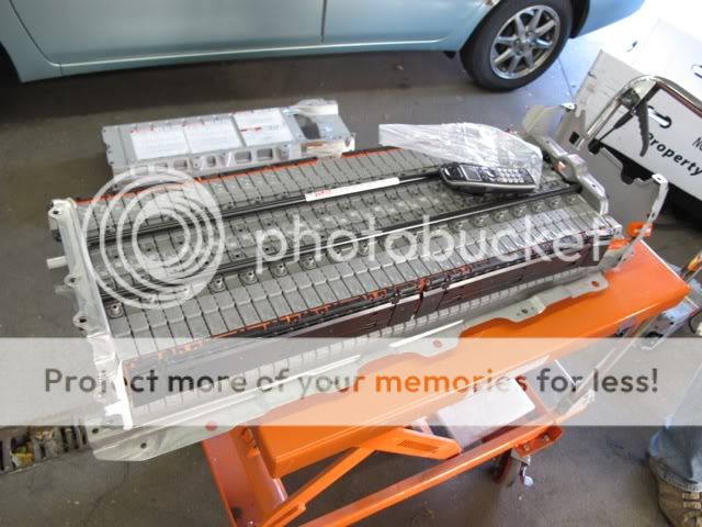

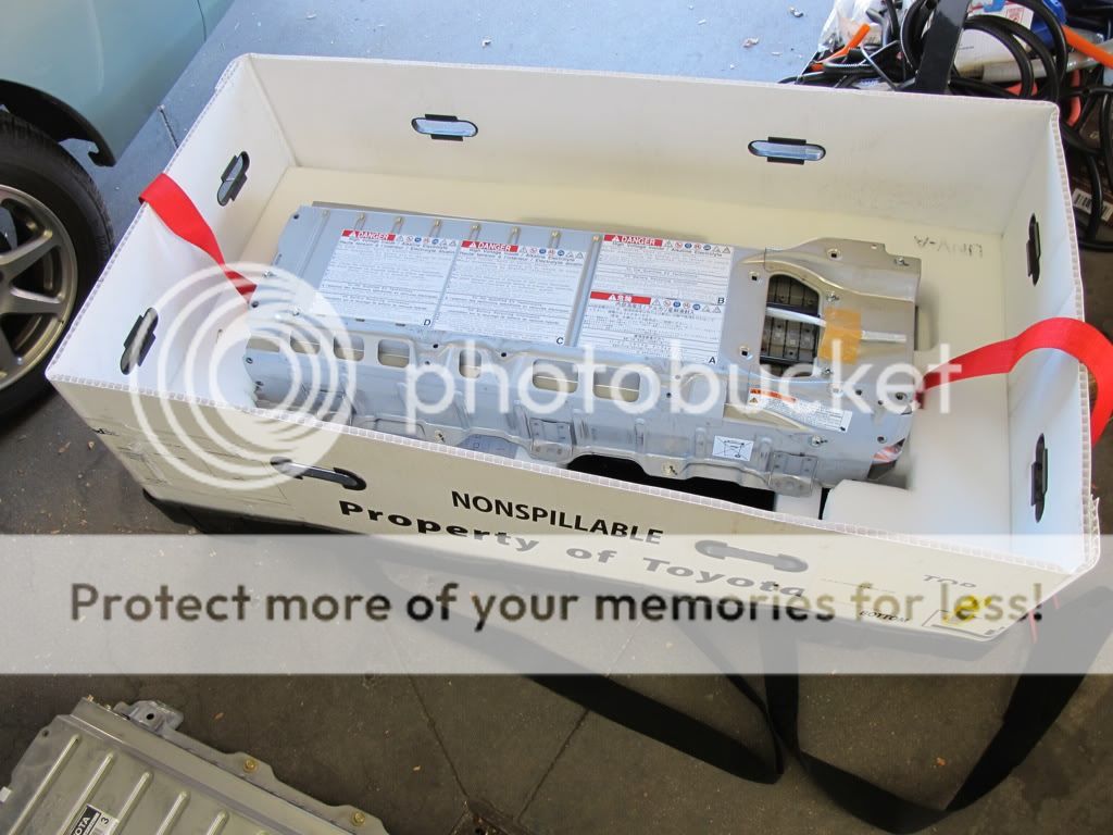

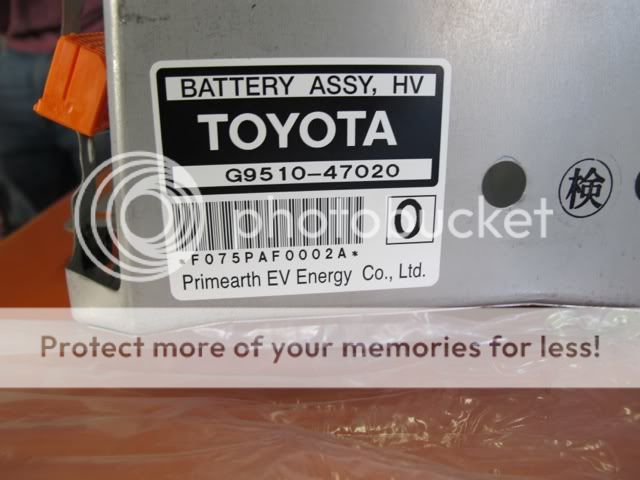

  9. 3prongpaul
    3prongpaul Hybrid Shop Owner, worked on 100's of Prius's
    Jul 18, 2010
    956
    730
    Boulder Hybids, Boulder, CO
    The modules can be moved to a different pack so the serial number on the sheetmetal is not definitive, but can certainly help.
    To know the true age of the battery you'll need to decode the data on the modules (I call them slices) themselves.
    Notice 3 large decals on top cover. This is how new batteries come from the dealer.
    Model/serial number plate on sheetmetal.
    "new" pack from dealer purchased November 2012 (what's under the cover)
    "new" slices from dealer battery purchased November 2012
