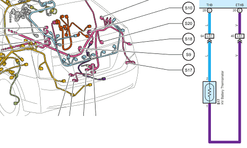

    Gen 3 does have a temperature sensor above the 12-volt battery. It is attached to the hold-down bracket and sits in the air an inch or so above the battery. So maybe it is more of a battery-surroundings temperature sensor than a battery-itself temperature sensor.
    It is called out in the wiring diagram as S17 and the legend says "HV Battery Thermometer" but I think that might be a mistake, 'cause the 12V battery is definitely where it's located. I guess you could say it's in the path of the HV battery "exhaling" air on its way out the quarter-panel vent, but that feels like a stretch.
    The diagram shows all the other HV battery thermistors wired to the HV battery smart unit, while this one is the only one whose wires go straight to the power management control ECU. I had always wondered why there was one HV battery thermistor wired differently from the others, but now it starts to make more sense.
    So it's possible that any scan tool that shows "HV battery" temperature readings might already be showing this one among those, and if they followed Toyota's weird labeling, it might be shown as an HV battery temperature reading, maybe for "exhaling" air.

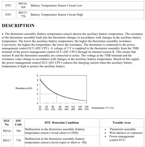

    Code P0517 Toyota Description The battery temperature sensor built into the generator control ECU assembly detects the battery temperature. A thermistor is integrated into the battery temperature sensor, and the resistance of the thermistor changes according to the battery temperature. The resistance of the thermistor increases as the battery temperature decreases and decreases as the temperature increases. The generator control ECU assembly reduces the amount of charging current based on this signal in order to protect the battery. The Diagnostic Trouble Code (DTC) will be set when the battery temperature sensor output value is abnormally high for 0.5 seconds or more with the ignition switch ON.

    That is some weird nonsense you found there. I'm not sure if it's that way because some AI wrote it, or just because some mixed-up human wrote it. It's another example of how often it happens somebody goes to sources other than the Toyota repair manual and gets caught up in bogosity.
    "Generator control ECU" is bogus. There is an "MG ECU" inside the inverter, but this thermistor is not wired there. It's wired to the power management control ECU, which is behind the glove box.

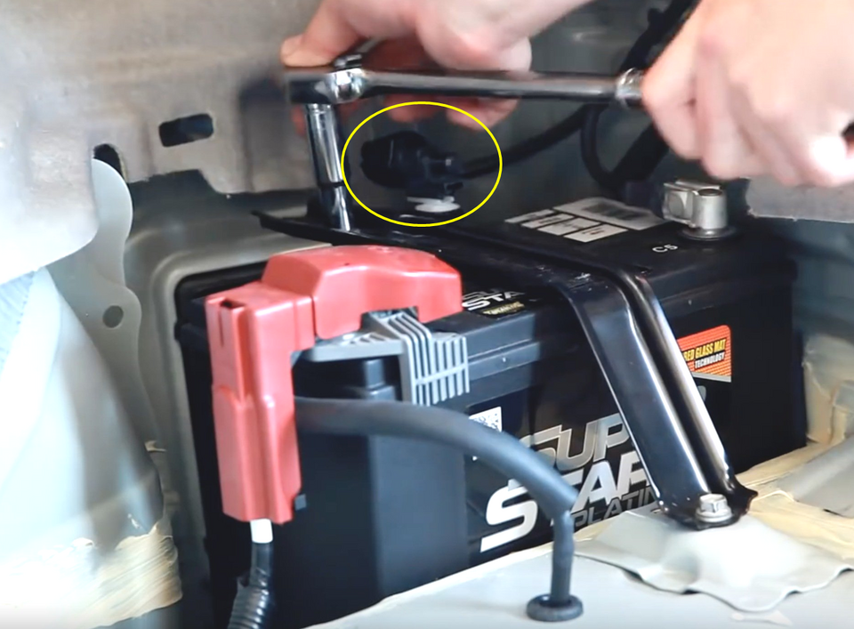

    I agree the description is some kind of Google translate text or possibly AI. The pictures are 100% correct. I saw this on my car. The sensor is mounted above the 12V battery on the hold down bracket. The other reason I know the code refers to the 12V battery is because I found the connector was loose. However, I still get sporadic code P0517 on Dr. Prius. Not sure if it's the temperature sensor/thermistor or the app, or the Veepeak OBDCheck BLE+ Bluetooth OBD II Scanner.

    See the temperature sensor location below:

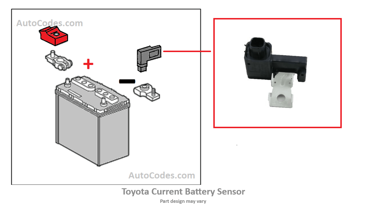

    The sensor is indeed mounted above the 12V battery on the hold down bracket. But it doesn't look anything like those pictures on gen 3, and the battery clamp assemblies don't look anything like that on gen 3 either. So the pictures are quite wrong also.
    At least you did end up looking in the right place and found the sensor. There'd just have been a lot less bogosity involved by going to the Toyota repair manual right off. It has the right text and the right pictures. :)
