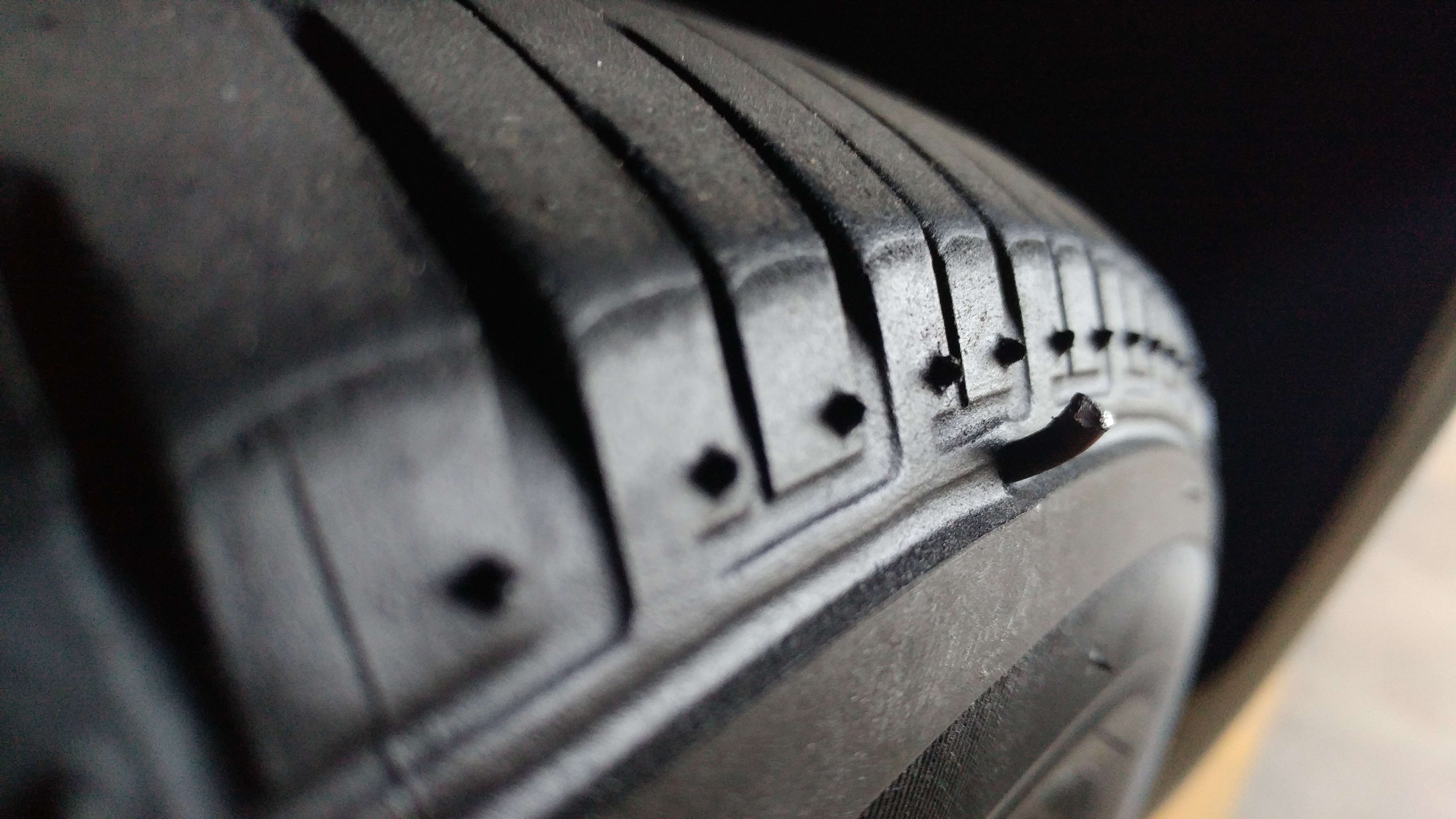

    I've encountered an issue with my back, left tire and wanted some advice.
    I noticed the low tire pressure light on my dashboard yesterday, and when I inspected the tires I found this
    [​IMG][​IMG]
    I really don't want to replace it, but I'm prepared to. These tires only have 25K miles on them.
    What are my options?

    The puncture is off the tread and on the sidewall. All service centers and tire shops will tell you this tire isn't salvageable and must be replaced.

    This is a replacement option only, don't repair. Your life is more important than the price of 1 tire

    Thanks for the reply, I'm assuming the pics worked. I'm not sure what went wrong there.
    Yeah, I was afraid of that. I suppose I should get the same make and model as the other tires?

    I can't see them, either on Firfox on a PC or Safari on an iPhone. Seems like some responders can see them anyhow. And yeah, hole in the sidewall you don't want to try repairing.

    Ideally, you want the same make and model of tire as a replacement. If you get a different tire, there is a slim chance of having the traction control wheel speed sensors detecting a speed difference between the two wheels, especially if they're mounted on the front drive wheels.

    That makes sense. Looks like I'll have to make a trip to Bridgestone then.
    Thanks for your insight.

    So I just got all four tires replaced. I recognize that at less than 30K, it might a waste to do so; but the Firestone place i went to had a sale on 'ecopia' tires. Might as well get that out of the way.
    Thank again guys!

    Good plan. Replacing one with the rest close to 30K will lead to hassles down the road.
