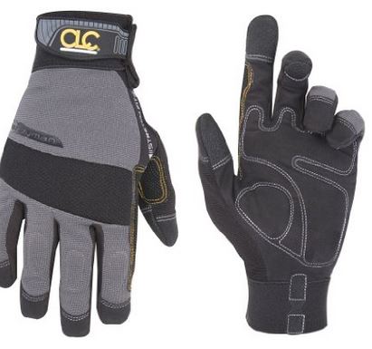

    It's also very nice to have some gloves in your kit to save your hands on cold wet evenings.
