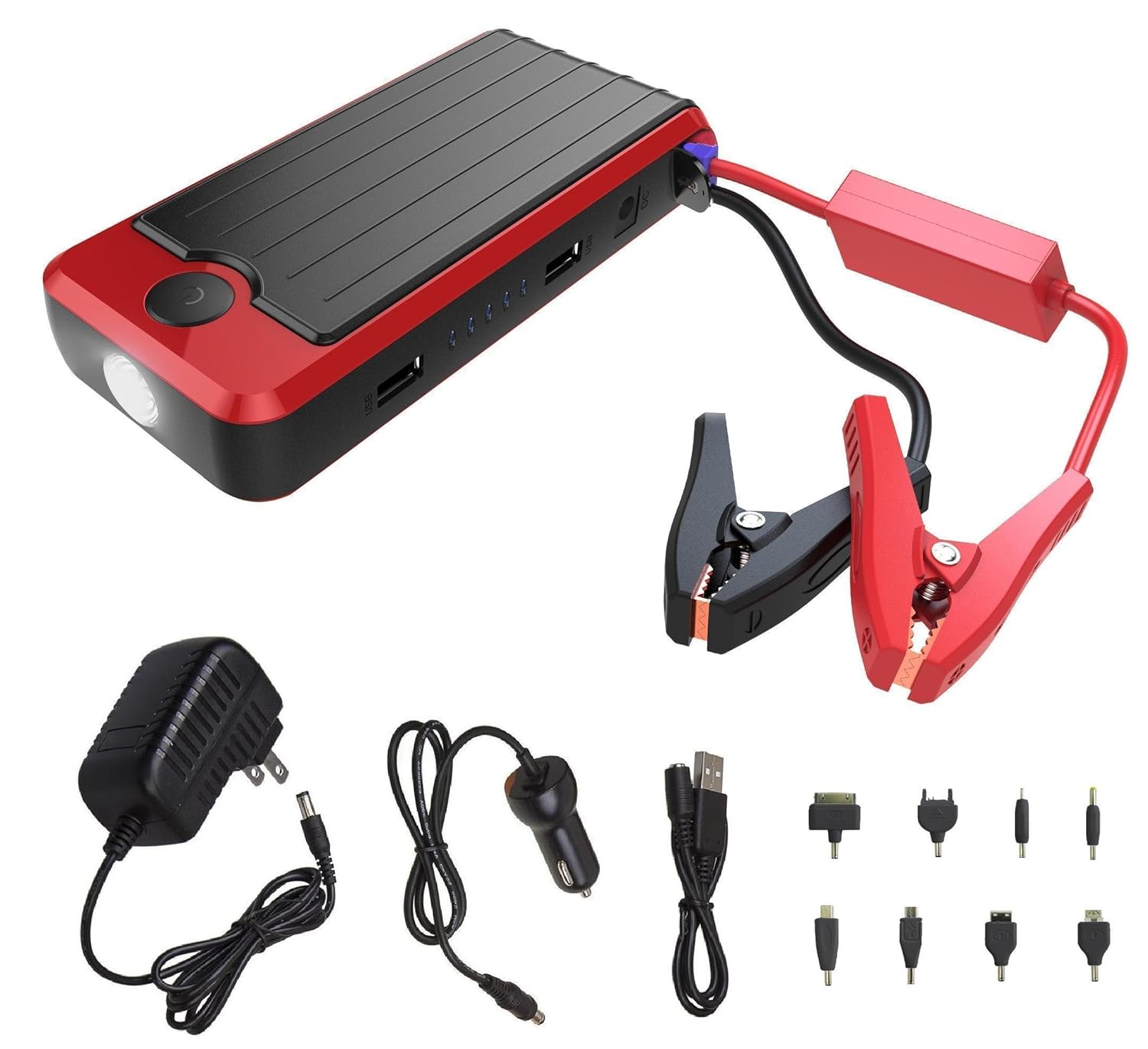

    As other's have stated, the answer is basically NO. You could jump start another Prius, but that is the limit. If you want to jump start someone, your best bet is to do it with a portable jump start pack. You can purchase those at your local parts house. It is also a good idea to have one just in case you ever need to jump start your Prius.

    Best advice is to monitor the voltage of the little 12 volt auxiliary battery and replace it before you need to jump start.
