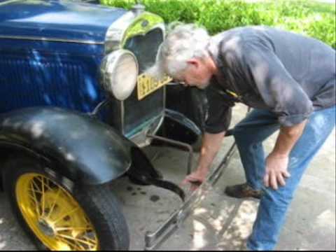

    All those "battery testers" at places like Autozone mean nothing to a Prius. A standard car draws power off the 12v battery to turn a little electric motor called a "starter".
    To start an engine you have to get it rotating first. It needs to be going and then you inject fuel and make a spark. If you've never done this:
    You may not appreciate how much energy is required to move an engine. The starter in a car does what that man is doing to that vehicle that doesn't have a starter. When you hear a normal car start the chugga-chugga-chugga sound before the engine kicks on, is the starter. It is a lot of work for a battery and THAT is what the battery testers test for. Can I drain you quickly for a relatively long period of time, or not. A Prius does no such thing.
