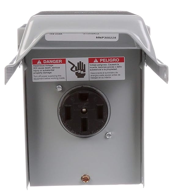

    get a short heavy duty flat extension cord
  8. PriusCamper
    PriusCamper Senior Member
    Mar 3, 2012
    3,720
    1,359
    Pacific Northwest, USA
    This is the way to do it... To spend all that money on a plugin car and not have something like this set up for both convenience and safety is a dang shame and disrespectful to the value of the technology as well...
