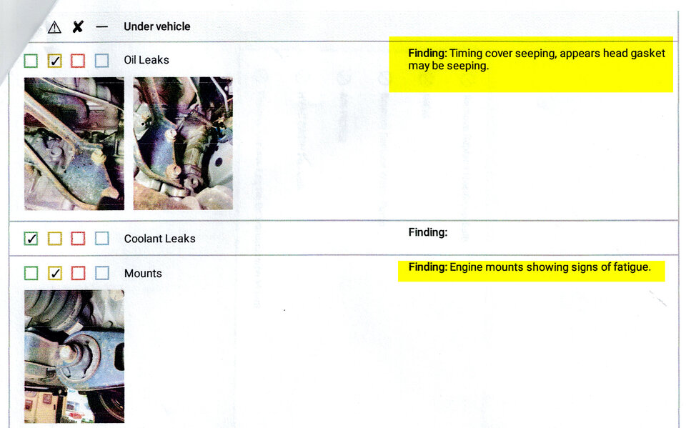

    Last year, and independent mechanic diagnosed as below. I chose not to take action on these items as they weren't dire.

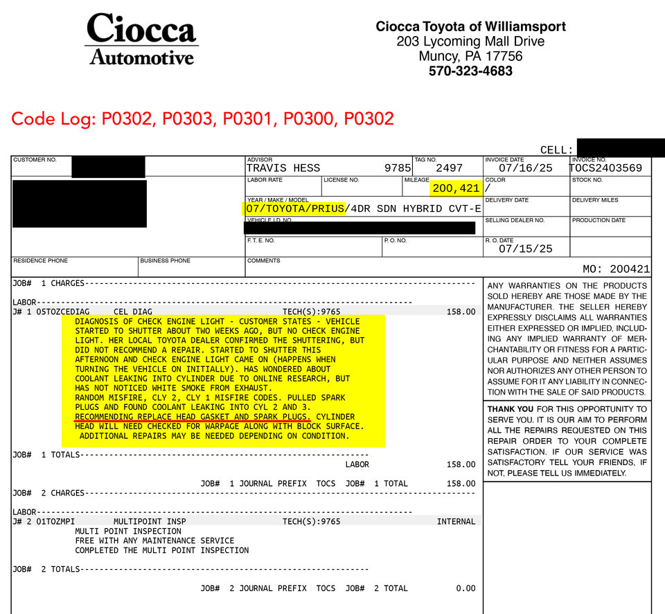

    Two weeks ago, felt a shudder on startup and then when it happened again, and out of town dealer diagnosed it as this:

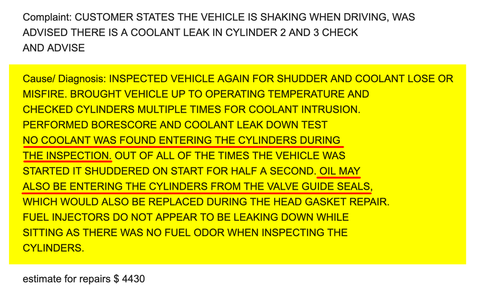

    When I towed it back to my home dealer, they were NOT able to reproduce any issues but when I pressed them, this was their report:
    Since I bought the car used in 2012, I've put $12k into major repairs. Over the 161 months I've owned it, minus regular maintenance like oil changes and such, that comes to roughly $160/month which was far less than a new car payment. However...I am truly thinking that with this shudder and a possible major gasket/engine repair, it's time to sell it for parts and start fresh. I am NOT a mechanically-inclined person and this decision has huge financial ramifications for me. Are the majority here in agreement that it's time to let this one go? She's at 200k miles, was hoping to take it to 300k, but I think we may be at the end of the road.

    The bad headgasket with coolant leaking into cylinders is only a problem with 2010-2015 Prius. Having a bad head gasket in a 2004-2009 is very rare and as most recent mechanic reported there's no coolant leaking into cylinders. And a hybrid car with 200K miles has a third or in some cases half the wear and tear of a regular car that's not a hyrbid.
    If I were you I'd get new plugs and coils and keep driving it... The slight shutter you're concerned about is still intermittent and even the very best most well cared for Prius will shutter from time to time. It's the nature of the Atkinson engine design.
    Just drive it till the engine fails and then swap out the engine with a used one. 2004-2009 are great cars and you'll miss how simple it was to deal with if you move on from it.
