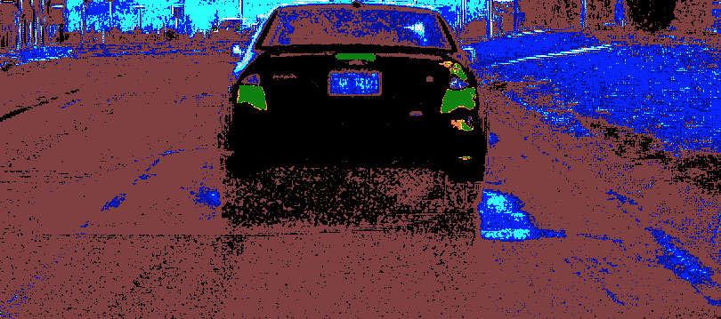

    This looks promising:
    Link: Black Ice Detection Technology | Intelligent Vision Systems
    Just tweak the camera a little to get the right resolution.... and Bazinga! :D
    Just move the camera to the rear view mirror. If you can't see you shouldn't be driving anyway.
    Who wants to buy one?
    Can you imagine having the suspected icy areas projected onto the windshield when driving !!!

  20. fuzzy1
    17,813
    10,602
    Buy what? I don't see a product being offered for sale, just a laboratory demonstration of a proposed technology. You still need to turn it into an actual working consumer product.
