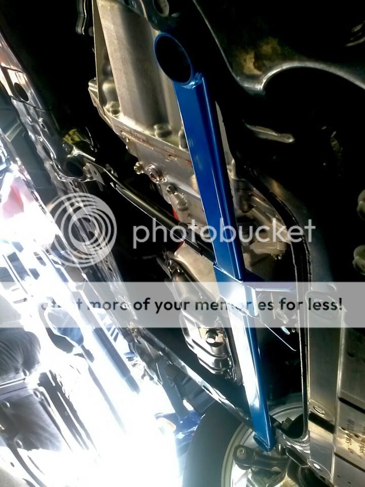

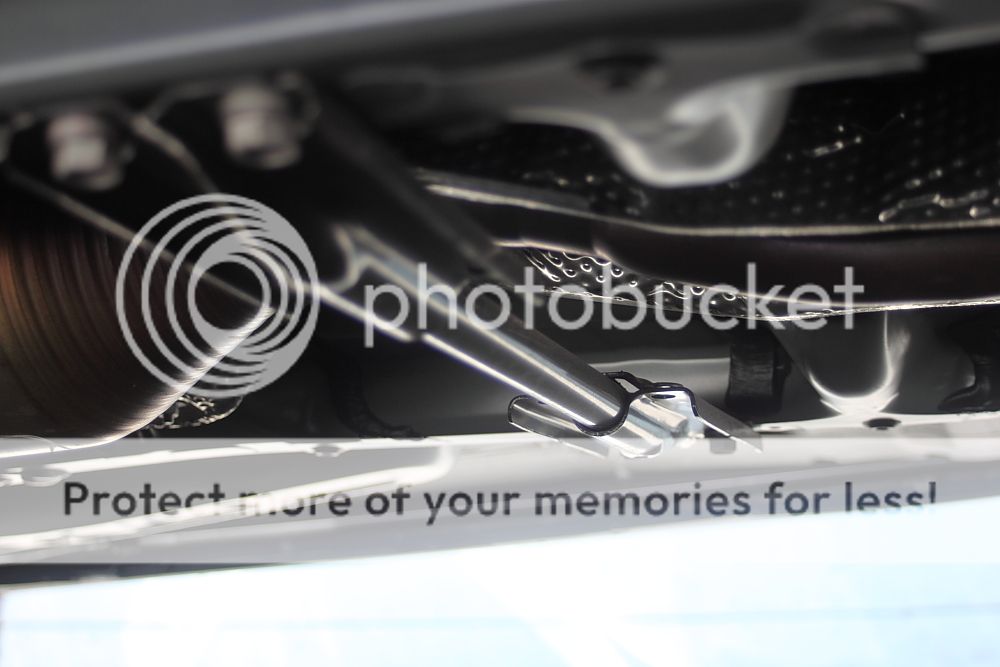

    Not long after, my first mod was a Cusco front lower brace that I picked up at the Cusco booth at Toyotafest. Steering response was improved.

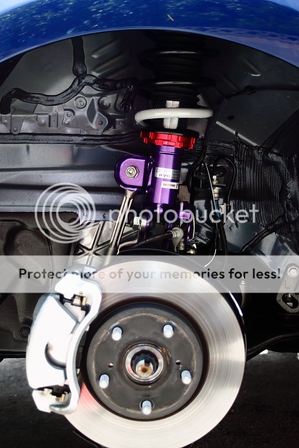

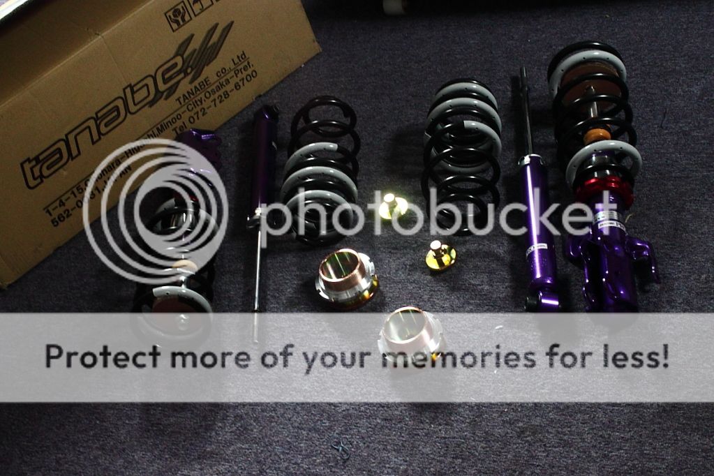

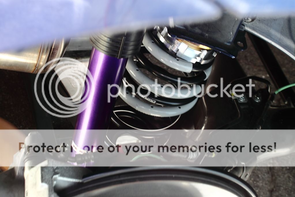

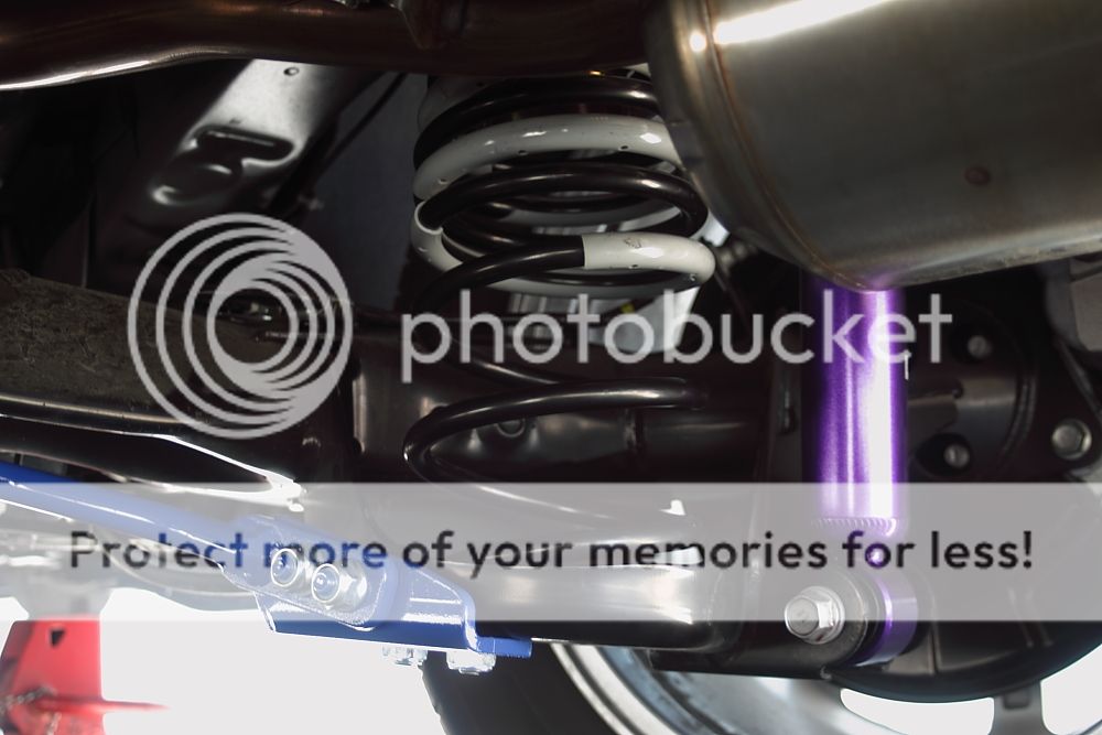

    Then the coilovers came in. Tanabe Sustec Pro.
    I picked Tanabe due to their spring rates. I liked how the rears were 4k. Prevents the rear from sagging when loaded up. I hate when the rear looks lower than the front.
    Onto the install, I'd have to admit they were too pretty to install, even if noone can see them haha.

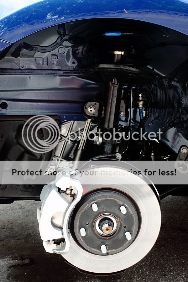

    Original.
    Sustec Pro
    Rear setup

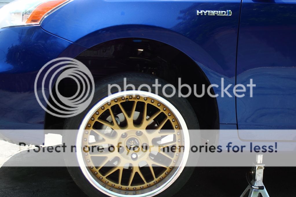

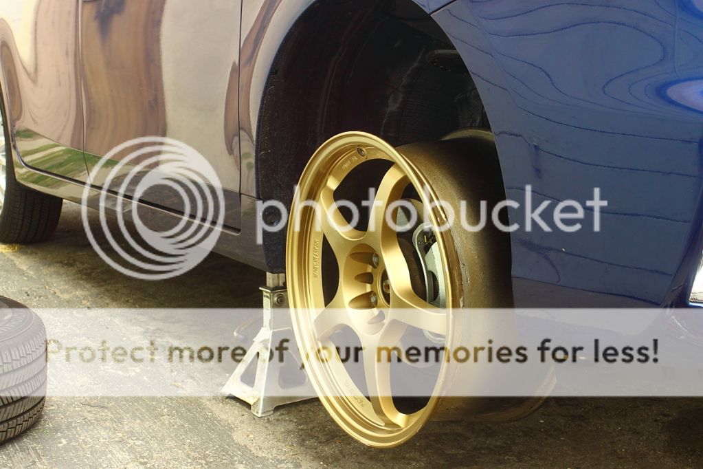

    All installed, but not done yet. Don't forget to test fit legit wheels. ;)
    The coilovers feel great, they felt like stock, I was afraid that it would've been too harsh for baby's head.
    *After a week of driving they're a little stiffer than stock, no biggie.

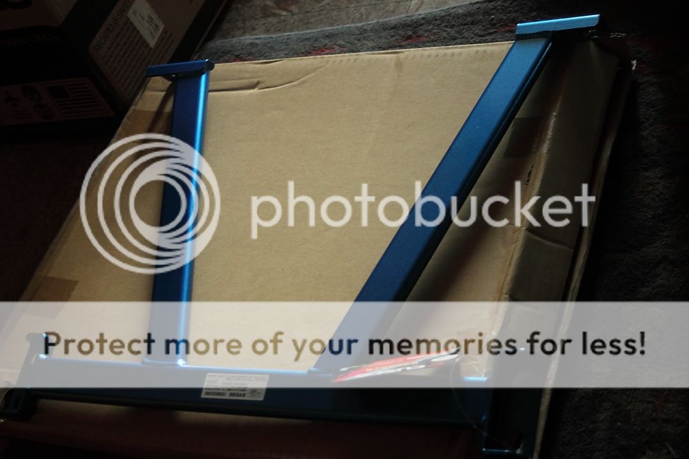

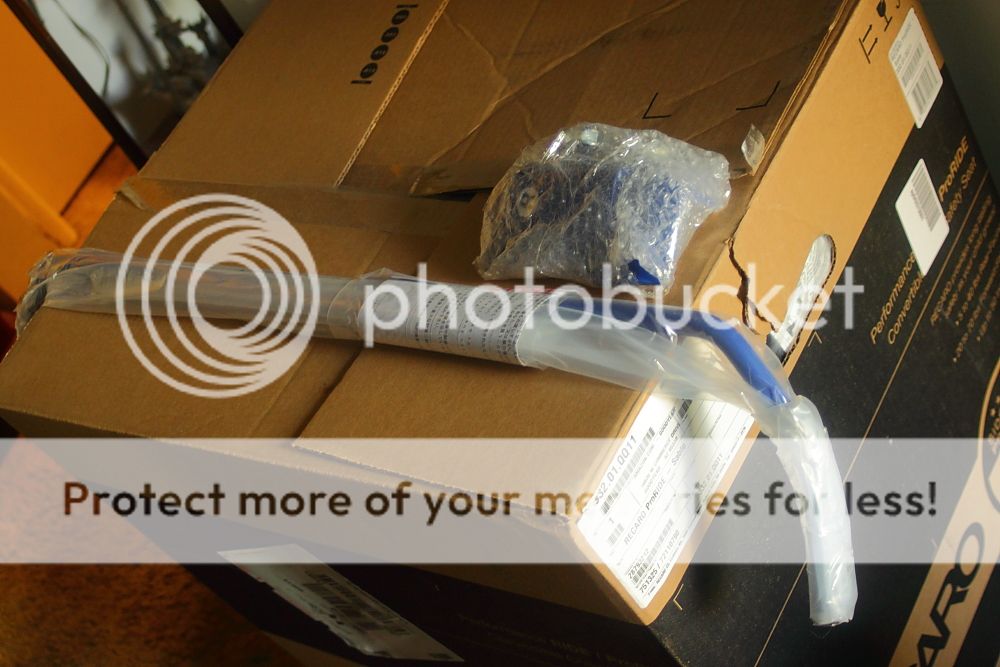

    Because these guys came in from Cusco:
    Cusco Center Brace.

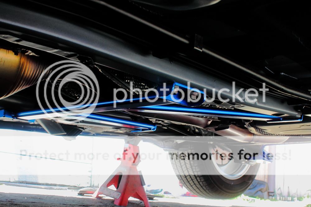

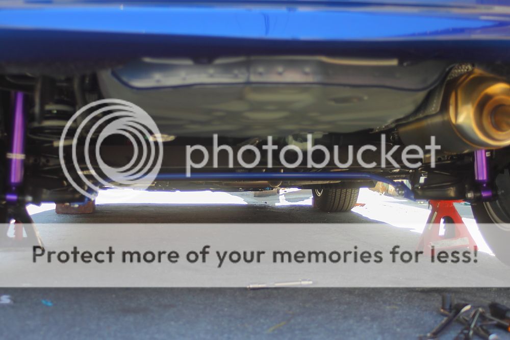

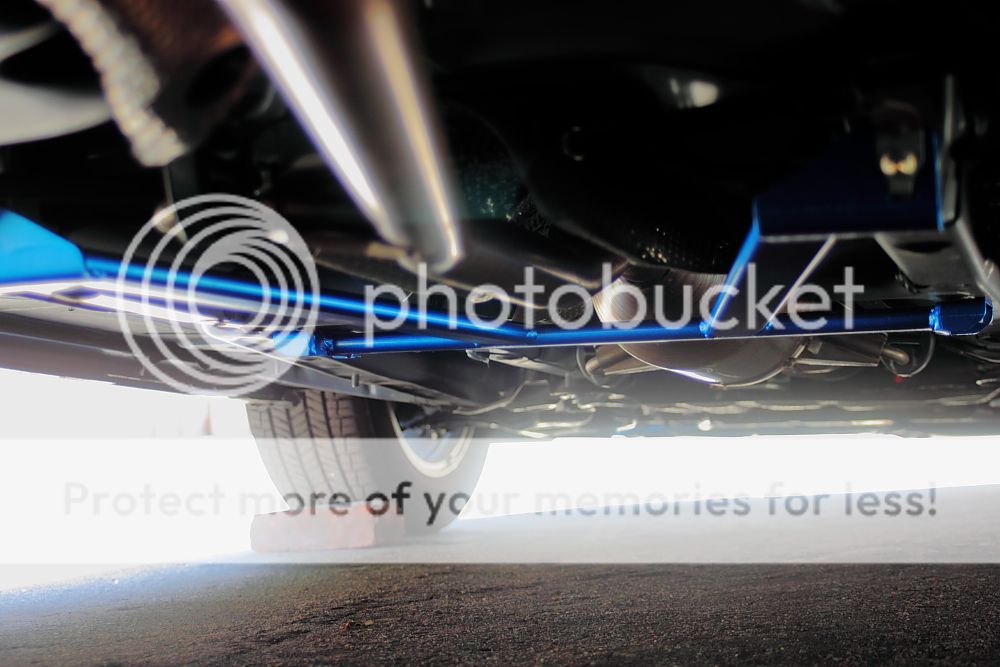

    Cusco Rear Sway Bar

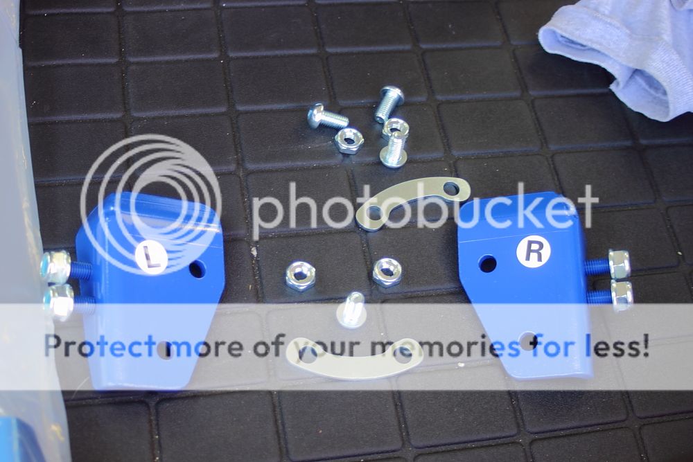

    RSB brackets and bolts.
    Brackets mount onto the lower spring perch.
    Installed.
    Stock center brace.
    Center brace installed.
    Took about an hour to install both items. The family wagon has even less body roll now.

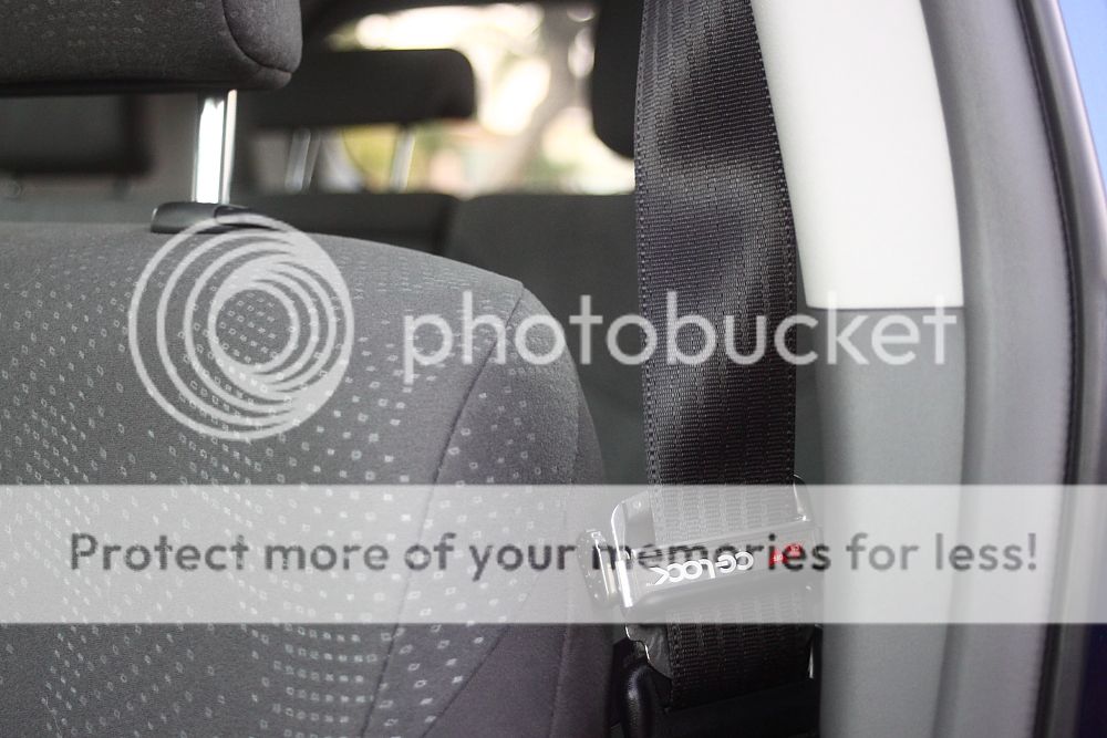

    So as I was rummaging around today, I found this CG Lock that I used to use in the MR2 when I first started autocrossing. Since then I've upped to a 6 point harness.
    Into the v it goes. :)
    If you don't know what the CG Lock is, it basically keeps your lap belt tight as if you had a lap harness. It keeps your behind planted on the seat, while your upper body is free to move around for everyday driving. :)

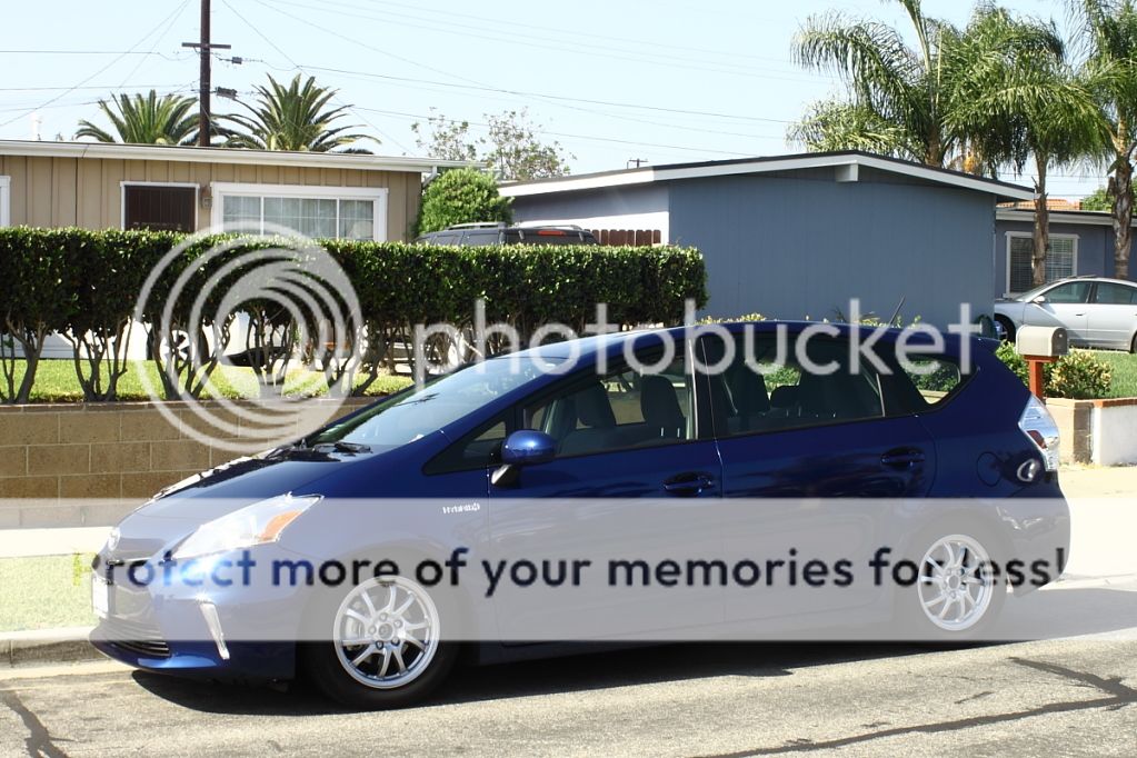

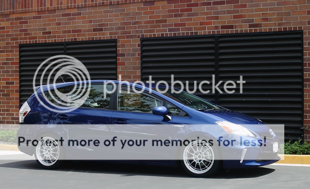

    Love it or hate it, I picked up some Enkei NT03+Ms in 18x8.5 +38. I had ordered SSRs, but decided to cancel them.
    Wrapped them in 225/40R18 Yokohama S drives. They have a slight stretch on the 8.5, just how I like it.
    Alignment wise, I'm running -1.4 camber all around. I used Toyota's 2 dot crash bolts on the upper and lower strut/hub mount to achieve the camber. Front wheels are flush with the fenders.
    Looks more proper now. I love the second ring because it creates an illusion that there is no gap between the brake caliper and the bigger 18" rim.
    Bye bye mpg.:p
    My buddies wanted to drive and ride in the v, so I took the opportunity to take a rolling shot. :)

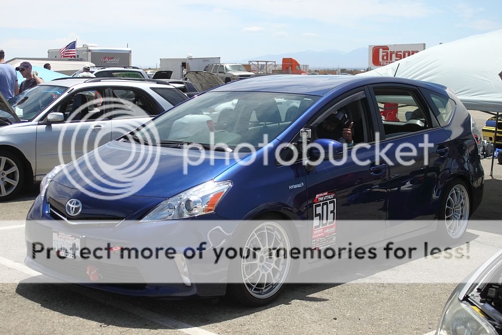

    Thanks! Well with my driving style and always with PWR, my best with the stock tire/wheel was 49mpg. With the new set up, I tried driving more conservatively (but with PWR still on), I was able to net 47.5mpg.
    Yesterday, I was only able to get 13.8mpg....
    Battle Stance.
    Streets of Willow Counter Clock Wise.
    Personal Best in the Prius: 1:45.xxx
    I decided to run in the beginner group because I didn't want to hold up the more experienced traffic, and I'm glad that I did because the intermediate guys and gals were running ~10 sec faster lap times!
    First impressions,
    1) She handles surprisingly well! Easy to control, and very predictable. I saw no signs of understeer, but that's probably because I couldn't get her going fast enough. :p
    2) Acceleration feels good on a fully charged Hybrid battery, but it only lasts one lap. The engine struggles by itself afterwards which sucks because the CCW layout on this track is mostly uphill.
    3) I don't like traction control.
    4) The A pillar takes up a lot of room, I first noticed when I was trying to look ahead at the apex...Wrong, all I saw was plastic, had to guess the apex hah.
    5) People kept looking at me weird for bringing a Prius to the track. o_O
    It was a fun experience to see what the Prius was capable of. The most frustrating thing for me wasn't the lack of power, but the limiting of power from the traction control system. Trying to accelerate to maintain the momentum through the corner or trying to apply throttle on exit kicks the traction control on every time. I would enter at around 45-50mph and end up exiting around 36mph. I tried messing with different throttle apply percentages, but if it doesn't turn on, I still lose speed. Not fun when you're trying to go up a grade.
    I don't think I'll take the v out to another track day, but I believe it would be a fun autocross car due to the quick spurts around the course, then forcefully charging the hybrid battery as you wait for your turn again.
    I feel bad for the bruised egos I caused to the newbies in the beginner run group...getting passed by a Prius...and by a v. :oops: So if you guys somehow find this thread, my apologies!
