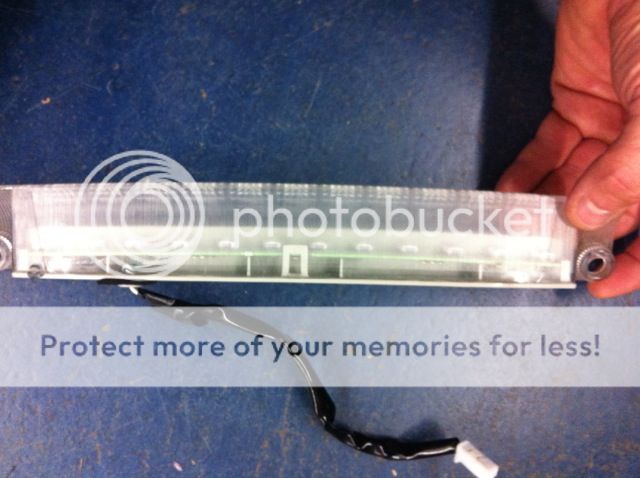

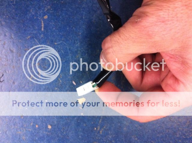

    I've heard of the Prius LED stop light strip "burning out" before so that is most likely your problem. It should power on with 12V. I think there are a total of 12 LEDs in the strip and some circuitry. Best to remove the entire strip and test with a battery on the bench, then test the power connector on the car with a voltmeter or test light. I think you have to remove the black inside liftgate cover to access the connector.

    We are talking about the brake lights in the units on either side of the car rather than the high center mounted unit. Unfortunately these are very difficult to repair effectively.

    Paul,
    Where is that located? That looks like the one on the hatch (3rd brakelight). The problem he's having is with the right side brake light(s).

    Sorry, my bad. I recently had a customer with bad center light and was thinking of that while reading the thread. If LED problem is in the right or left taillight most likely water got in. Easiest way to fix is purchase a new (aftermarket) taillight on Ebay. They are good quality and only about $65-$80 delivered. You could try and take apart the light assembly and fix the LED circuit board, but you'll see it's not designed to come apart to be easily serviced.
