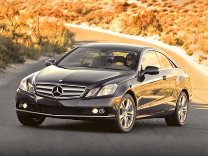

    i believe you and i understand completely:)
    there is, however, a mercedes with 2 sets of lights below the headlights. 2010 E350
    Additionally, in that image there are 3 discrete bodies of light that are lit: low-beam, foglight and a small 5W 'city light' in the high-beam housing.

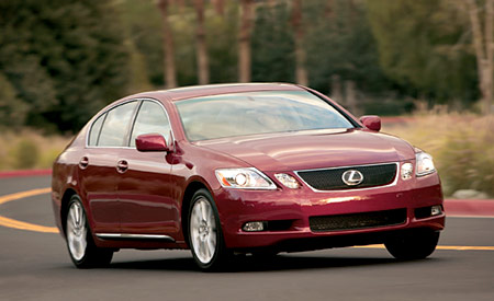

    There are other cars that also have 3 discrete bodies of light on when you drive (if you have the foglights on). Another I can think of off the top of my head is the Lexus GS350/460:
    or the porsche turbo (the last light on the LED bar is used as a DRL), so there are 3 discrete bodies of light. EXHIBIT E:

    having said that, you are probably right in that my DRL's (or any additional lights added on a car) are considered illegal. as with many mods, if it didn't come from the factory that way, it is probably not legal.

    That mercedes benz picture is the most intriguing and contradictory to my prior statements...
    I say you have nothing to worry about. I would be incredibly surprised if you ever got in trouble for your mod.
