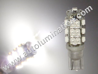

    ah ok, well i've heard good things about autolumination.com. never bought from them, but i know some people who have and have said good things. prices are high, but they're quality products from what i've heard. (one of those you get what you pay for kinda places)

    That Darell guy here, checking in. Though I have made some of my own exterior LED lights, I don't sell them because of DOT considerations. You get hit and the other lawyer finds out you don't have DOT signal lights, and you can miss out on collecting what is due to you.
    I also need to point out that in general, you will be disappointed with any drop-in replacement for exterior lights (this is above and beyond the fact that they're illegal in the US). The fixtures are made for incandescent lights. LEDs are FANTASTIC when the fixture is made for them. Not so great as a retrofit. Many reasons for this - and one is how waste heat is dealt with. Incans NEED to be hot to operate. LEDs need to be cooled to last. Very hard to retrofit one situation with the other.
    If you want red light - with or without a red lens - ONLY use red LEDs. The reason is simple: If you use a white LED, the red lens will filter out 50% or more of the photons that LED emits. Very little red is evident in a "white" LED - and red is the only wavelength that will pass through the red filter (lens).
    Don't do it. Only use red if you want to pass red light through the lens. Incandescent has a huge red component, and much of it will pass through the filter to make you happy. Not so with "white" LED. White LEDs are made with blue emitters covered with a yellow phosphor. Very little red content. You can see this for yourself by shining a white LED flashlight through red wine. It will be almost as if you have no light on. Now try it with an incandescent flashlight.
    Anyway... my stick-in-the-mud suggestion is to not replace signal lights that you life depends on, with drop-in LED solutions that won't be bright enough, nor legal.

    you can always sell them as Off road only/ show, which removes any liability from yourself. If you're choosing not to do this simoly to "look out" for people, that's cool too. its funny how insurance works, the tails on my SHO are probably not legal, however they look and perform 100 times better than stock tails. LEDs are brighter, longer lasting, had have quicker response times than incandesents (milliseconds, but every bit counts)
    while i agree with you that retrofits are better than drop ins, there's a few points i'd like to contest- it's actually quite easy to do a LED retrofit (custom, not a drop in bulb) and keep the heat down, both by driving the LEDs at a slightly lower amperage than rated and also using a PWM (pulse width modulator) to dim rather than resistors. the array in my current car's tail lights puts out almost no heat after being on for extended periods of time (cool to the touch after an hour).
    the best type of LEDs to use for a retrofit is actually red LEDs behind a clear lens and RED/ORANGE leds behind a red lens. the red lens will filter the red LED and make the color look dull or off. red/orange and a red lens gives the best stock color appearance.
    using superflux LEDs or CREE's (although CREE's typically need a heatsink) it's possible to make tails and turn signals that are actually brighter than stock. NOTE: i am only advocating a custom made solution, using PCB to arrange LEDS in an array pointing out of the car, NOT the drop in bulbs that direct light into the light housing (another aspect of LEDs are that they are manufactured with differing viewing angles for light output, as opposed to incandescents which throw light in all directions.
