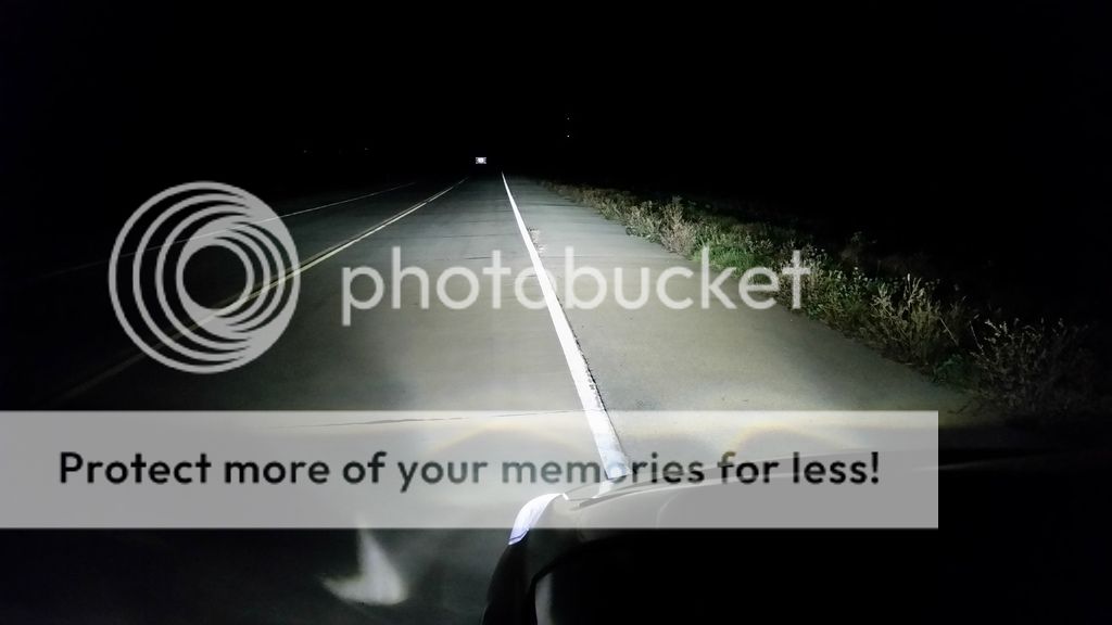

    That was me. The Corolla LEDs are as bright, but aren't quite as wide as most OEM HID beams, but have better distance lighting.
    Something to keep in mind: if Toyota could just drop in LED bulbs in halogen housings for a few bucks, would they spend the extra money on proprietary (expensive) LED headlights for the Corolla, Prius, etc.?
    Night shot:

    Comparing the above picture against factory LED lights:
