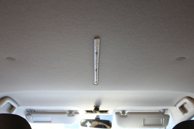

    I know many people have complained about the poor interior lighting in the Prius C. I felt the same when I bought mine a month ago. After reading some of the posts here, I went to buy some LED replacement lights for the existing fixtures, but two local auto parts stores were out of the ones to fit my car. But the second store, Pep Boys had a large supply of LED products and I walked out with a package of two LED strips in Bright White. They packages had a battery and a switch built-in so you could test the lights before you buy. They seemed plenty bright to light up our car. So I bought them. ;)

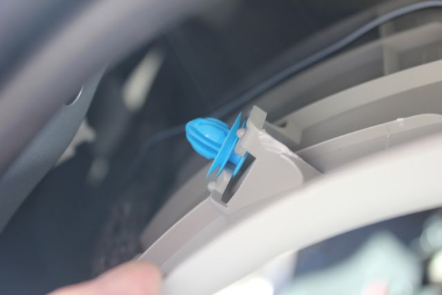

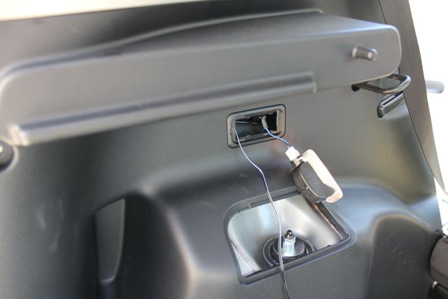

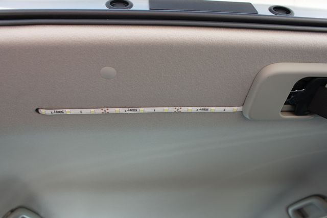

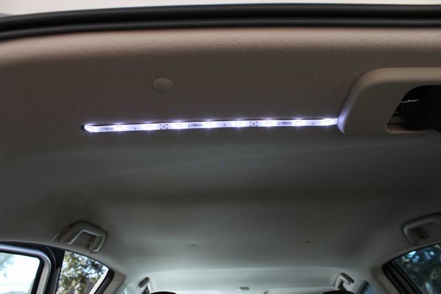

    Installing these lights were sooo easy. I would highly recommend them. They have 3M double sticky tape on the back of them with a wire coming out one end. They are designed for 12 volt car systems. So looking into my mounting options, I started with the rear hatch light. I supported one end under the trim for the middle seatbelt storage area and drilled a hole in my headliner the appropriate distance away. I made the hole oval shaped similar to the shape of the lighting strip and passed the wires through. I removed the backing off the double sticky tape and pushed the wire end of the LED strip into the hole and pressed the adhesive to the headliner. I popped out the trim pieces that were in the way leading to the hatch light and fed the wire though. I soldered these wires to the wires leading to the regular hatch light and put everything back together. Time spent was less than 30 minutes.

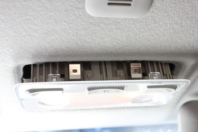

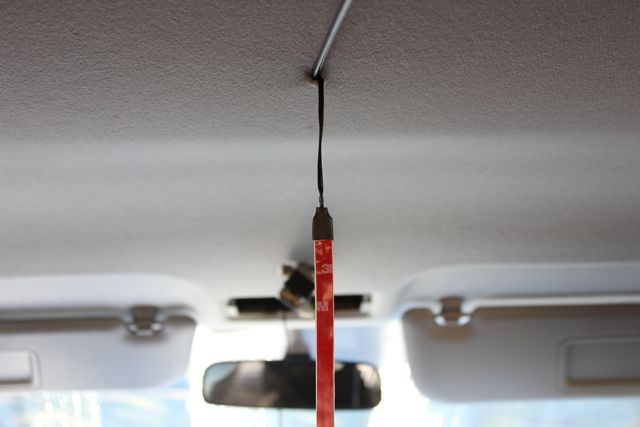

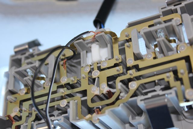

    The second strip LED light I decided to install mid-cab. I picked my location and drilled a second hole into the headliner. I removed the front light by pushing on the metal tabs holding the light figure in place. I removed the microphone for good measure too. I taped the wires to the end of a long stiff rod and passed them through the hole to the front with little difficulty. I used the adhesive to adhere the LED strip to the headliner with this LED only being supported by the hole on one end. (We will see how long it last.) Being a little indecisive on how I wanted to wire this light and thinking I may add a separate switch later. I decided not to do anything permanent and twist the wires around the strips of conductive metal on on regular light. I covered them with electrical tape. I chose to come off the drivers map light to allow the passenger to turn on his map light without disturbing the driver as much. I put everything back together and spent just over an hour total time.

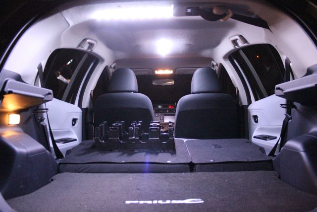

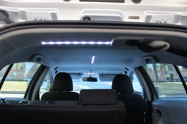

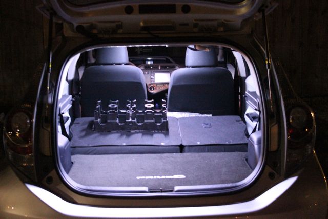

    The results are amazing! This is the lighting Toyota should have had in the first place. IMG_5430.jpg IMG_5431.jpg IMG_5432.jpg IMG_5434.jpg IMG_5435.jpg IMG_5438.jpg IMG_5440.jpg IMG_5442.jpg IMG_5444.jpg IMG_5447.jpg IMG_5448.jpg

    I left the headliner on. I just drilled into the headliner and fished the wire through with the metal rod shown. For the back I did pull down the corner of the headliner to help feed the wires. Yes. They come on and off with the existing lights. Yes for the front lights I did twist them around the metal in the light housing. I did this on a temporary note in case I wanted to change it. But it has been fine so far.
