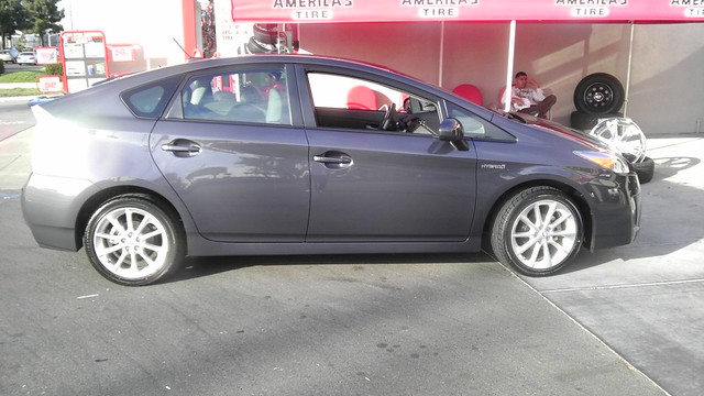

    Can we see some CT200 wheels? I am thinking they will actually be hitting the used market quickly. I am seeing CT200's EVERYWHERE (except my garage). Did they only offer 17's?
  12. Here are the CT wheels on Blinkn09's car.
