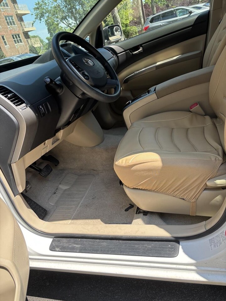

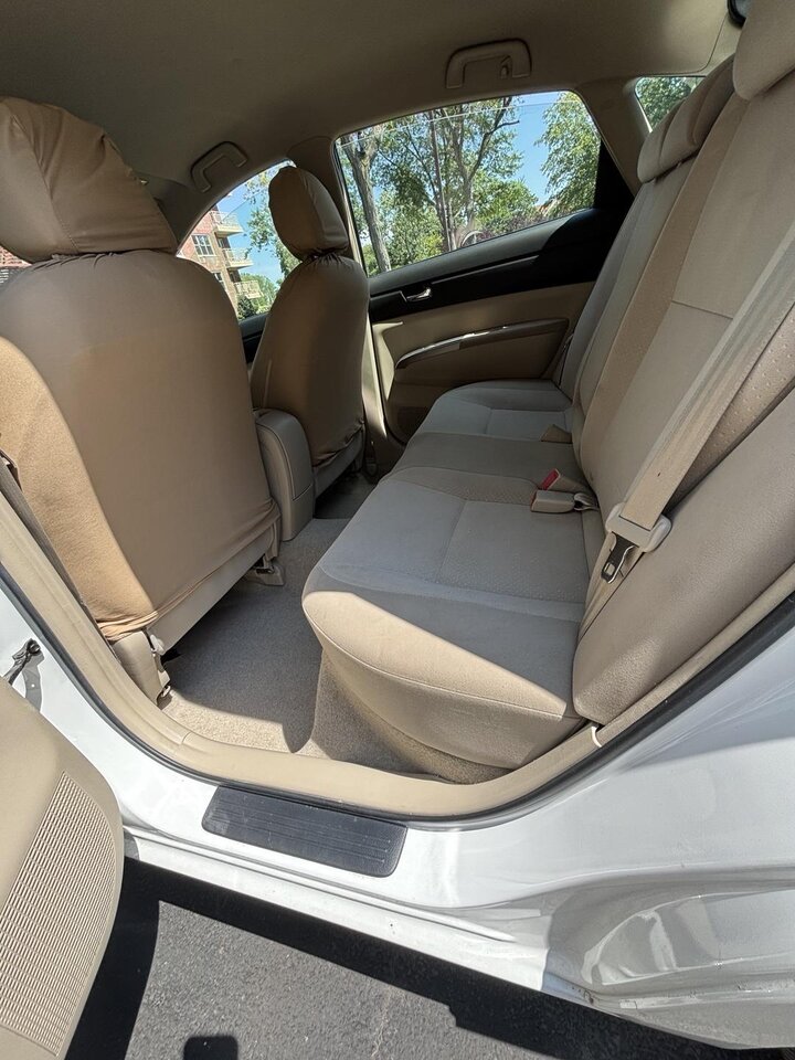

    My 2005 Prius sustained a light water damage during heavy rain two weeks ago (rising water from the ground), but was driving fine until today when it wouldn't turn on at all. As you can see from the picture, the seats are clean so the water level likely did not even go up to that level.
    Our long time trustworthy mechanic on the phone says that the car is likely not salvageable, which I find hard to believe given the extent of the damage.
    What self-diagnostics can I run in this case to determine that the car is indeed unsalvageable?
    Thank you!

    That car isn't very broke

    Until you can clearly articulate the actual water level the car was exposed to both us and our mechanic have zero ability to tell you how damaged it is. The water level could be accurately indicated by the flood marks on the wheels.
    In the meantime, I'm with Tombuk2 on this... Your pictures so zero indication of water anywhere and even if there were minor puddles inside the car the hyrbid equipment is higher up than that.
    I bet you haven't put a charge on your 12v battery in a long time and then you left the car doors open for a while when trying to dry it out and now your 12v battery is drained down.
