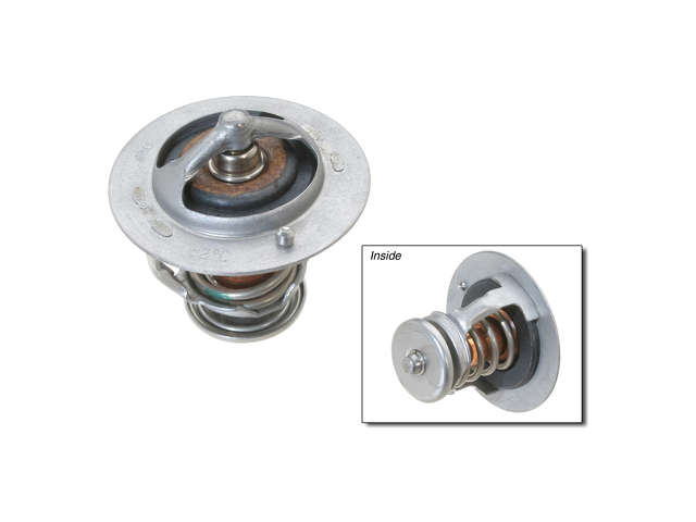

    I was wondering, does the Prius engine also have one of these mechanical thermostats that would pop open and close or is it all electronic? My E46 BMW was always running too cool, because the thermostat snapped its' plastic retaining clip. [BMW used plastic in that car in places where metal should have been used instead].Replaced it and the temperature needle went back to the middle. It's never cold enough here for an always open thermostat to be a problem, but a friend of mine said it's bad for the engine and the CAT won't work properly. You'll just use more fuel.

    It's a mechanical thermostat. It nominally opens at 82°C, but a range of 80°C to 84°C is permitted. Picture:
