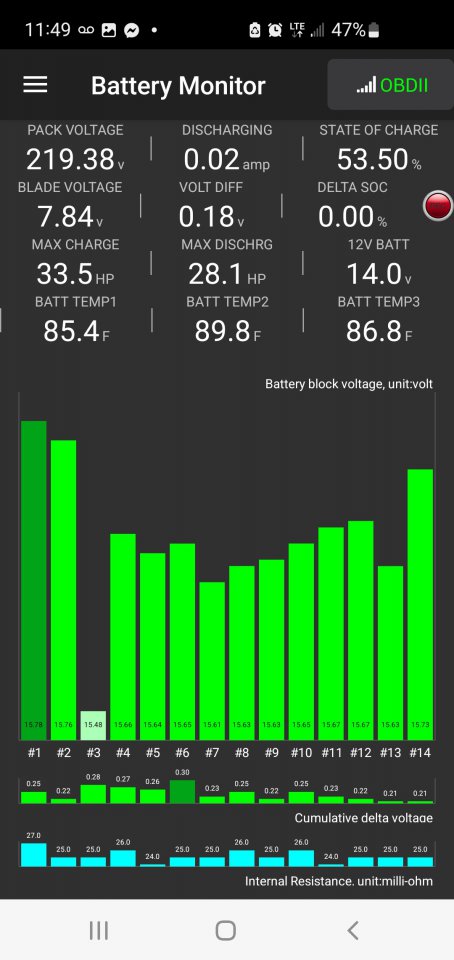

    That's the the guide I used. I ended up going with the panlong. Here's the vitals for the battery.

    That number known as voltage difference indicates you have a weak module... When the amp number above it goes really high the voltage difference number will too, which triggers the red triangle.
    If this is the first bad module in the pack people have gotten as much as a year out of it by buying a replacement module for $35 from Professor Joe at https://2ndlifebattery.com/contact-us/
    If you want to recondition the pack on top of this rebuilding work, as well as balancing the pack, we can walk you thru all that so you can get as much life out of the pack as possible.
    However if you have enough cash and want to upgrade to lithium click link in my signature below to learn more or you can buy new OEM or a rebuilt pack from Professor Joe with 3 year warranty, though his 1 year warranty packs are of the same quality.
    And if you're gonna replace rather than repair you can just keep clearing those error codes and drive the pack into the ground as long as it doesn't get so hot it pops its tops...

    I see the diff voltage of .18v
    I'm assuming by the chart it's module #3 that is bad.
    Tbh I would like to replace it but the website in your profile appears to be out of 2nd gen batteries
    so It appears ill need to do some rebuilding until a new one becomes available. But I don't understand what reconditioning and balancing means exactly. I've got an idea what balancing means but don't know how to do it.

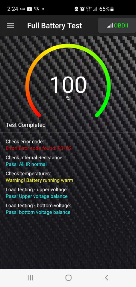

    Okay I'll get the codes from the full battery test. I've just been nervous to perform it because it asks you to park your vehicle and Rev the engine a bunch but I'll have to put the parking brake on and hold the brake pedal down. Probably nothing just made me uneasy.

    Heres the results of the full battery test

    So Dr Prius is reporting a P3102 from the hybrid control ecu. Assuming that's accurate, then there is also an INF or detail subcode present that gives more info about the fault. You need a more capable scantool to view INF codes or get codes and data from systems such as "transmission control" (parking pawl mechanism).
    The link (above post #4) to the scantool review thread on PriusChat shows several capable scantools (such as Autel AP200).
    All the P3102 codes show that wiring-connectors, transmission control ecu, hybrid control ecu, or power source control ecu can all be possible problems. There's no direct mention of the parking actuator causing this code.
