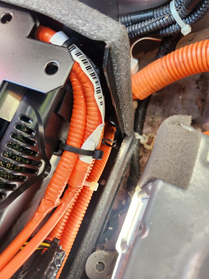

    I have worked on hybrids and EVs for over 20 years. Definitely have worked on Hymotion systems during that time. Most of the time it was taking them out after they've died for one reason or another.
    I hadn't seen any for quite a while. I was really surprised when I opened the back of this car and saw the Hymotion system.
    As expected, it wasn't operable. After a lot of troubleshooting and searching through the car and wire harness I found the main problem. Mice had taken up residence *inside* the system itself and chewed off a temperature sensor wire.
    Fortunately I have extra Hymotion modules in storage, and I was able to plug in a different temperature sensor to get the system running.
    Edited to add a pics, including a pic of one of creators of the Hymotion System, Ricardo Bazzarella (left) and me (right) when he came to Green Drive Expo 2009.
