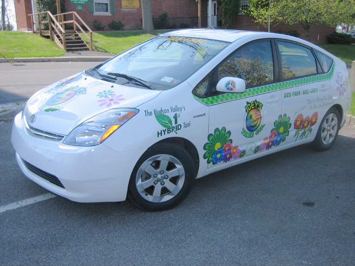

  17. Doc Willie
    Jun 27, 2007
    1,717
    142
    Out there, somewhere
  18. halpos4
    halpos4 "Taxi"!
    Aug 13, 2008
    377
    Ireland
    Wth,Do they supply paper bags for passengers to place over their heads when they're being transported......or maybe plastic bags for the "I wouldn't be seen dead in that" types!!
  19. Doc Willie
    Jun 27, 2007
    1,717
    142
    Around here, people are tripping over each other to try to get a ride in this cab.
    We are only 20 miles from Woodstock, NY, and we haven't forgotten.
    Peace, bro'
