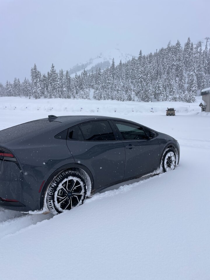

    Honestly I'm glad I sold my stock wheel setup and grabbed some light weight 16s and CC2s. Winter driving has been great and I've got enough tread wall where I have very little concern over wheel damage. Even just on wet roads there is a noticeable difference in grip. Had a couple light oversteering on wet roads with the stock tires but same roads, weather, and speed with the CC2s never have an issue.
