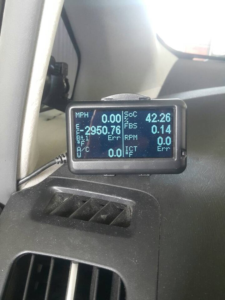

  17. AzusaPrius
    AzusaPrius Senior Member
    May 27, 2020
    2,137
    900
    No it is poor design for toyota to not have the coolant temp displayed.
    Get one any one, there are even apps you could use to monitor the temp.
    The dumb too late light that turns on at or around 248F is no good and that is why everyone blows their headgasket.
    Multiple times of seeing that light come on is no bueno and the temp should be monitored constantly.
    Below is a picture of mine when I first got it.
