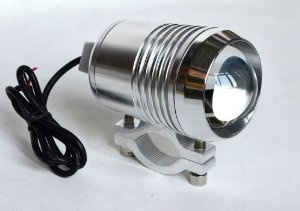

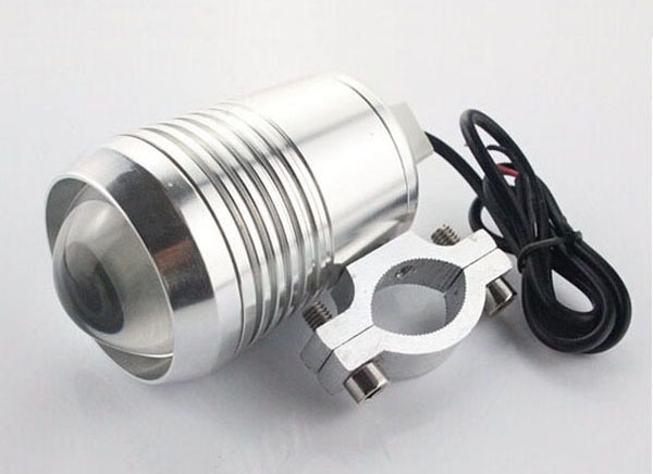

    I found these leds on the net. Powerful, short, focused, 12w and 12v.
    Different mounts. Cheap. $30 for two. Only problem they have 3 settings.
    Strobe, low and high.

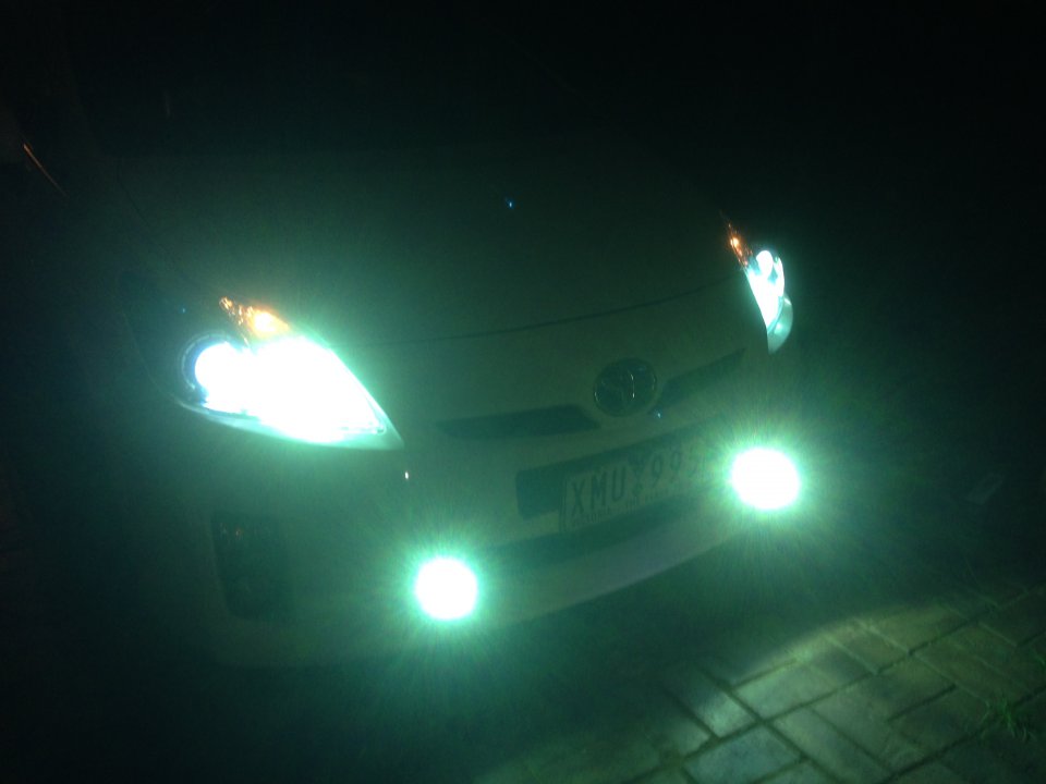

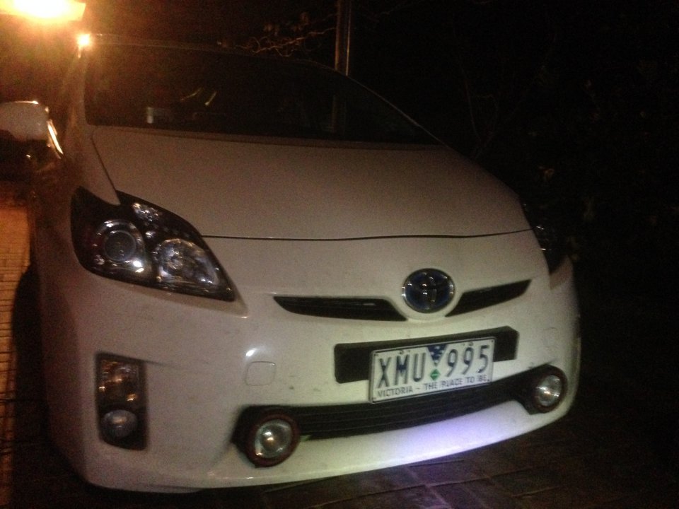

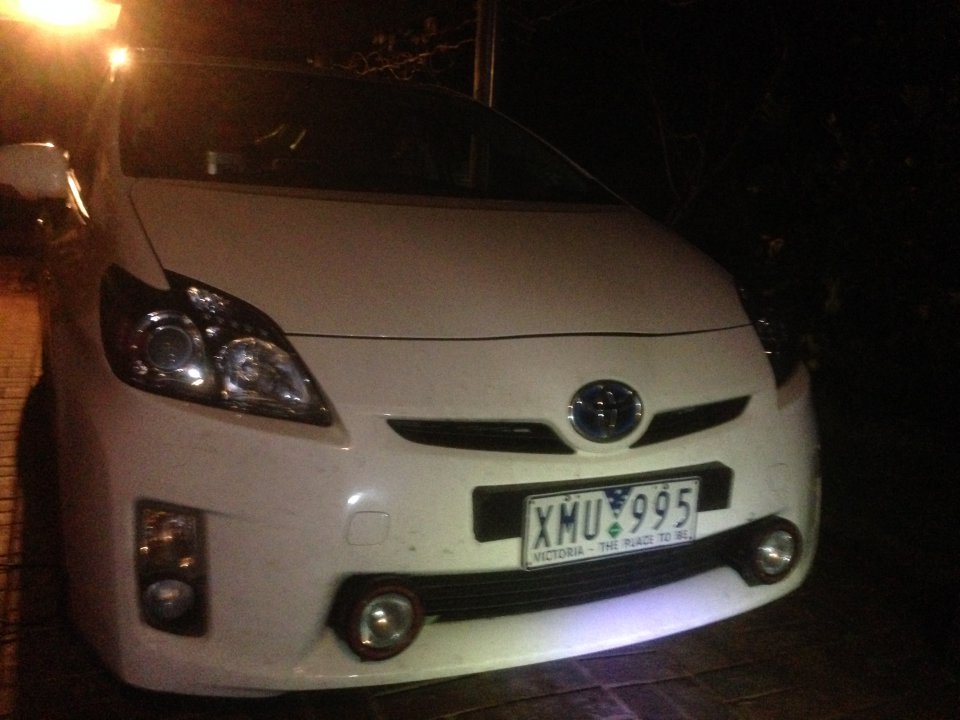

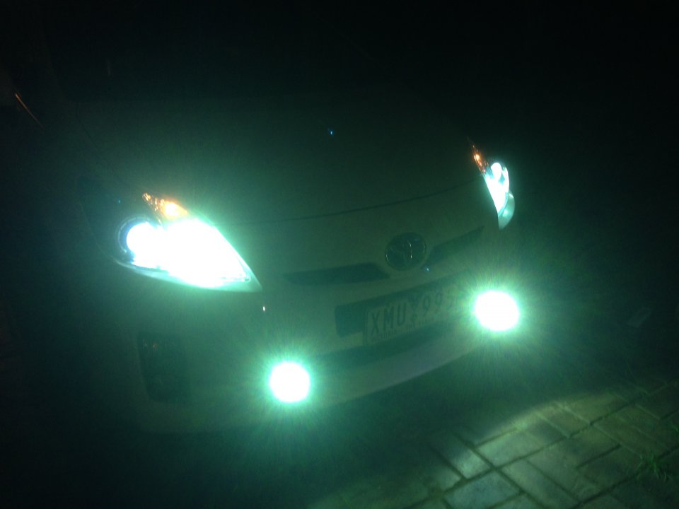

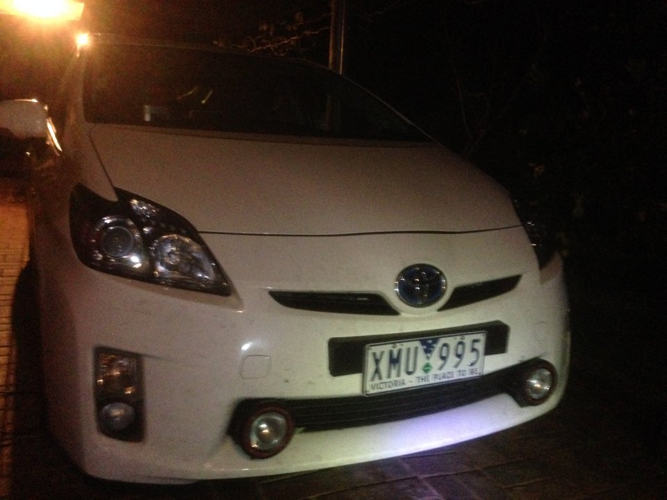

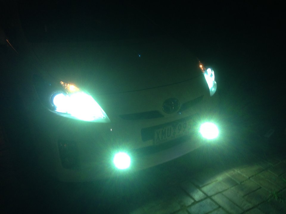

    The retrofit is good if you want to spend that much. I have had a great deal of satisfaction from simply fitting a set of HID H11 bulbs and ballasts to the standard Prius headlight projectors. 160,000+ Kms and still working well. High beam is more of a problem but I fitted 4" HID spotlights to the front spoiler with no loss of fuel efficiency. This area is well into the "dead" area around the grill where minimal extra drag is created. I had to cut away a small section of grill to enable the lights to sit back enough.

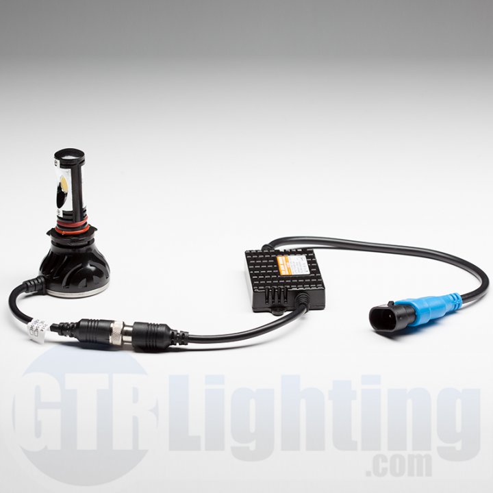

    So I found this LED headlight conversion kit on the net and the reviews looks ok. $180.
    They are also easier to install (small, less wiring, instant on) than HIDs they say and only 28 watt per H11 bulb.
    LED Headlight H11 Conversion Kit: 2,200 Lumen Bulbs - GTR Lighting
    50 watts to spare is nice, I think.
    Anyone tried these LED conversion kits?
    Rubbish compared to HIDs?
    I apologize if I break any advertising rules. I do not work for this company.
  12. xliderider
    7,869
    3,116
    The light pattern from those are poor because they are far from point light sources like the halogen filament or an arc from the HID bulb.
    There are 35w HID systems as well that claim about 3x the light output compared to a halogen system. For best visibility, use 4300k HID.
    For the $180 you're willing to spend, you can get a good quality HID system.

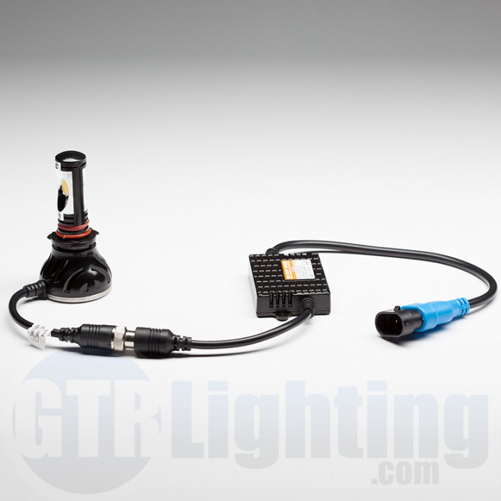

    My .02, this is better, I'll be testing this tomorrow:
    I expect 3400LM out of this and that is on par with an HID but should be much much much cleaner light.

    Prepare to be disappointed.

    Source?
