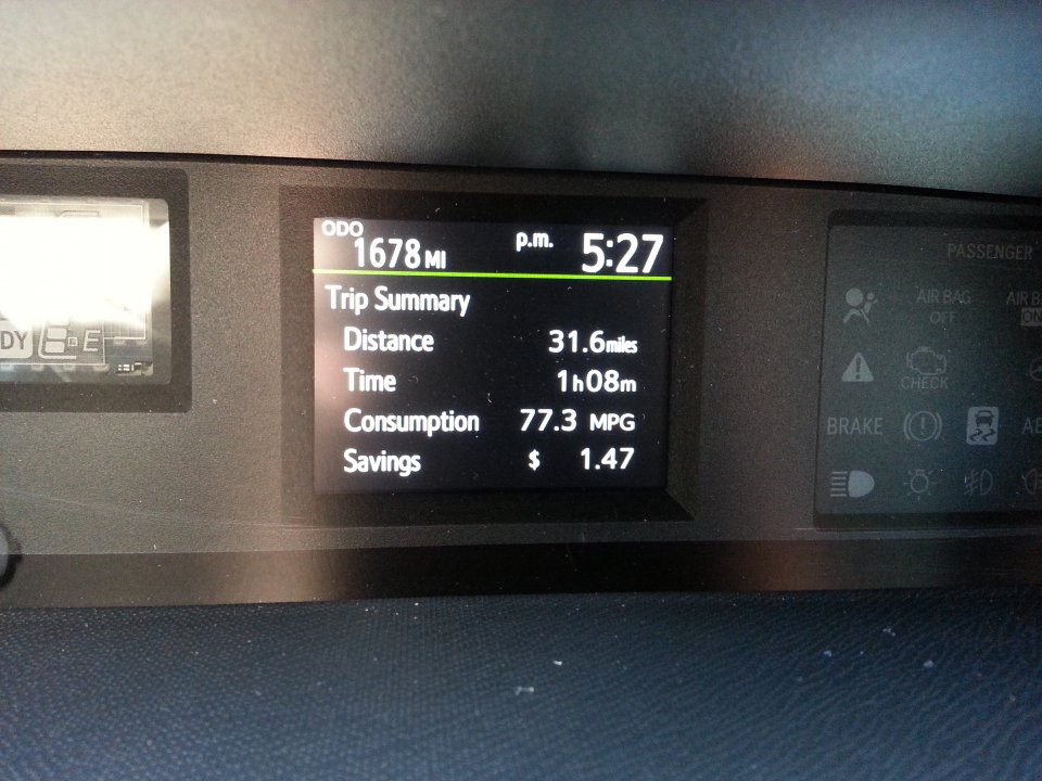

    Was a bit early getting to where I was going tonight so I just went for a fun drive... wasn't even thinking about driving efficiently (though I guess I do now habitually). I love how effortlessly the car posts the numbers cruising around at city speeds. NB. This was off a completely warm start after a short stop.
    65.3 MPG, Average 19 mph, EV distance 9.26 miles, 59°F.

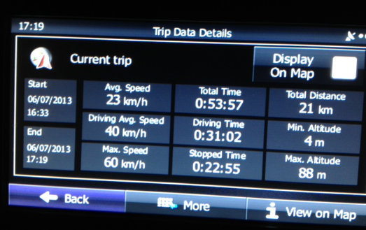

    Only thing is - I noticed a discrepancy between this data and that recorded by the built-in GPS:
    I took this two minutes later, yes, but the start time is right. So what does the car mean by "Driving Time" on the MFD? I may have to take my GPS data logger next time to compare logs with the built-in GPS.

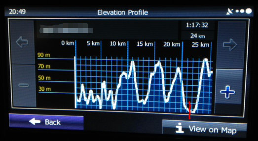

    Later on in the evening I realised an elevation profile was probably in order. The red line indicates where I was when I took the above images.

    wow that's quite a discrepancy I was going to say driving time is time spent in motion, but the gps also lists time stopped and 31+22 does not equal 44, and the start and end times add up too 46 mins, not 53, do any of these figures actually add up ?
