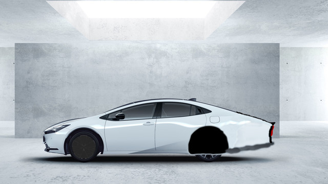

    heres a photoshop version of an aero prius. should get 70 mpg easily
    garen2001 and model464 like this.

    Kinda looks like a Ioniq 6
