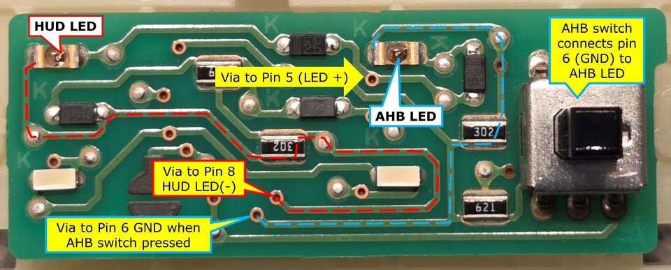

    Does anyone have the wiring for this switch?
    This version of the switch has both the HUD (Heads Up Display) and AHB (Automatic High Beams) buttons.
    The switch has 10 pins connected to a 12-pin connector.
    This is what I think I know so far:
    Pin # Wire Color (purpose)
    Pin #1 Green (?)
    Pin #2 ?
    Pin #3 ?
    Pin #4 Black (?)
    Pin #5 White/Black (ground)
    Pin #6 Red (power)
    Pin #7 ?
    Pin #8 ?
    Pin #9 ?
    Pin #10 Yellow (powers the AHB LED light)
    Appreciate any help. Thank you
