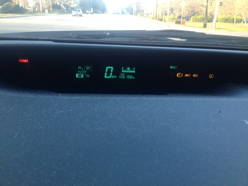

    My wife has a 2007 Prius with approx. 110k miles. We installed a new 12V battery approx. 1 1/2 year ago at 81k miles. A few months ago (Mar/Apr), her dash would randomly display the warning lights shown in the 1st image: Brake System, ABS, and VSC (the TPMS light is always on due to faulty tire pressure sensors and appears unrelated).
    The car seemed to be driving normally with no abnormal behavior. Whenever this happened, my wife would pull over, turn off the car, and restart - at which points all the warning lights would disappear.
    Even though our 12V battery is relatively new, I did check the voltage of that battery using the MFD's on-board diagnostic screens as explained by other posts on this board. Voltage was within the normal range with the HID lights both on and off.

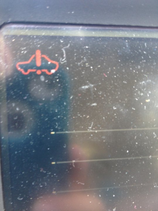

    The lights hadn't come back on for a while, but today we now have different warning lights as shown in the 2nd and 3rd images: Master Warning Light, Check Engine, and Hybrid System (red exclamation point set inside a car symbol). My wife says the engine seems to be working harder than normal when taking off from a stop, which I believed to mean that the hybrid system may not be engaging as normal. However, the hybrid battery seems to be going through normal cycles of charge/discharge as indicated by the multi-function display.
    We are going to take the car into a dealership tomorrow but wanted to ask in advance of that if anyone on the board has ideas on what may be causing this - and whether the two sets of warning lights are connected? I tried searching other posts on various combinations of warning lights, but couldn't come up with anything conclusive.

    Is the HV battery fan constantly running? Does it go from full charge to low charge within 30 seconds? If not, its very hard to diagnose a car that seems to be running fine without knowing the DTC's.

    I would first check all the fluid levels in your car, oil, coolant, etc. This might be a case of a failed inverter pump, it should be covered under warranty if you have not yet done the recall.

    Yes, it very well could be a failed inverter pump. We have been seeing a lot of them lately on here. Check this by turning your car on and checking for turbulence in the inverter coolant reservoir.

    Thanks to everyone for the help. The car unfortunately died at a stoplight on the way home before we could take it into the dealership. My wife confirmed that the hybrid battery charge level on the MFD was at zero, but was able to get the car to a nearby gas station under minimal battery power and then have it towed to a nearby repair shop. The car has the following codes:
    P3000 - Hybrid battery malfunction
    P3016 - Cell #6 voltage issue
