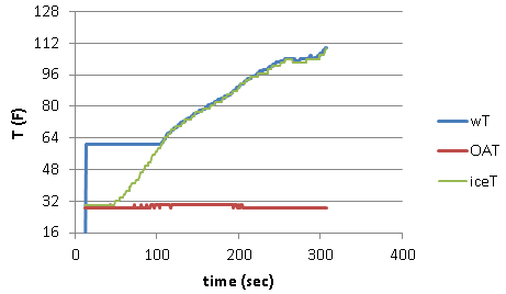

    Not sure about the warm up stage skipping but I think Prius is pretty smart about deciding whether to transfer coolant between the thermos and the engine cooling loop depending on the coolant temperature measured at various places - in order to optimize fuel efficiency. Maybe your driving pattern is such that when it's below freezing the temperature distribution of the coolant just happens to make the transfer unnecessary.
    Here are two examples recorded during two separate trips with an identical initial outside air temperature of 28.4 F (below freezing) - my Prius decided to do the transfer in one but not the other:
    Hope this helps. :)

    This is news to me - you're saying it purposefully doesn't always transfer the coolant at startup? How do you measure the water temperature separately from the engine temperature? It looks like in your first chart that the coolant temperature was in the 140's but didn't get circulated past your sensor until the 7 seconds had elapsed and the engine kicked on.

    Yes you can imagine (in the extreme case) if the coolant in the thermos is colder than that in the engine loop then there is no point of doing the transfer at startup.
    The temperatures are available at the OBDII connector below the driver side dash. See my PriiDash(TM) project for more details. I don't known where exactly the sensors are but they agree well with the engine coolant T reported by standard OBD requests using ScanGaugeII.
    I think the sharp rise in coolant temperature corresponds to the transfer of hot coolant from the thermos into the engine cooling loop sometime before the engine starts. Once the engine starts the temperature actually drops, presumably due to mixing with cold coolant from other part of the loop since the water pump is driven by the engine.
