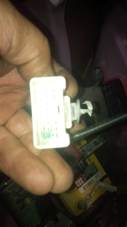

    I'm using the one in the picture with the "Torque" light app

    Wouldn't stress it, you can upgrade to a mini-vci later. You should focus on DTC P0A1D.
    Check for water ingress in the rear hatch areas, including the left/right cubbies and the spare tire well. You will have to remove so plastic trim as well. If standing water is found, there are rubber plugs you can push out until you can find and fix the leak. While you have the back trunk area taken apart you can clean the HV fan, and check/clean both pieces of the connector for corrosion (pictured below), which you will find mounted above the 12v battery. This last step could be the cause for the retrieved DTC P0A1D.
