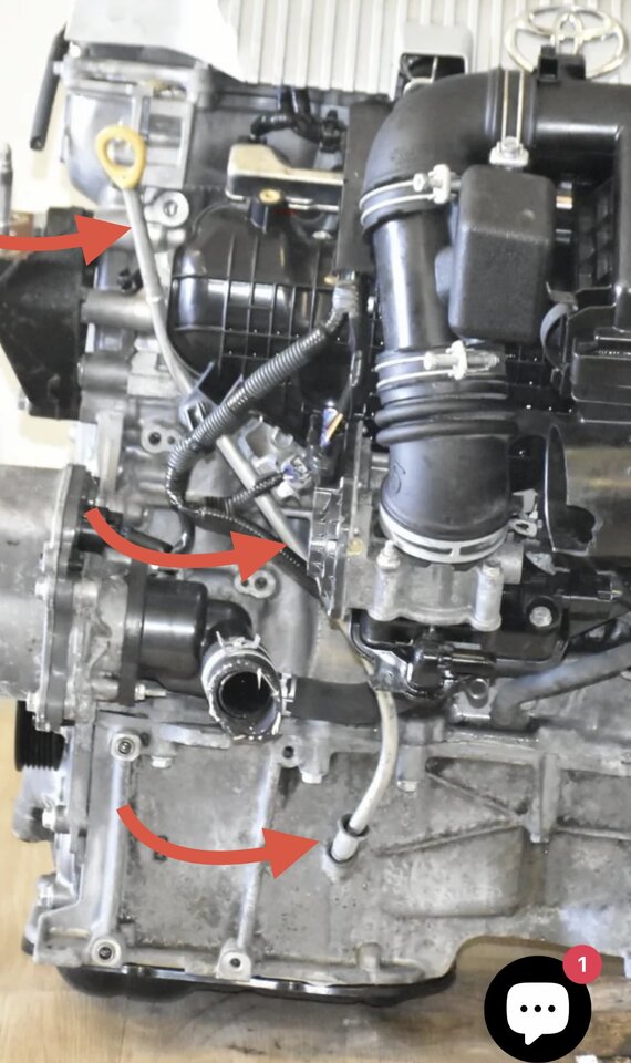

    If you wonder why it's easy to smear the dipstick oil level, here is the twist and turns it goes through when pulling it out.

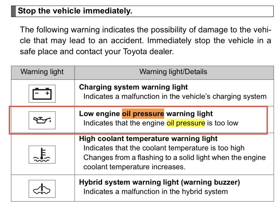

    One more sanity check:
    1. This is the light you are seeing, correct?
    2. Did the dealer actually charge you for anything or did a service advisor just talk to you and then said everything was fine?
