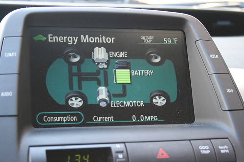

    I bought this car new almost 5 years ago next month. Whenever I have driven downhill for large periods of time (which is often, since I live in the rocky mountains!) I have always noticed that the battery gauge on the "info" screen fills all the way up. That is, until last weekend. I was driving downhill for about 30 minutes, clearly enough time for the battery to fill, yet the final bar on the info screen never showed up. It was always one bar away from the top.

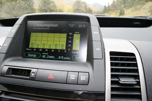

    I think what you are seeing is normal. I never saw a "full" battery on my 04 and have not seen it on my 09. I do have to admit that I usually have the Consumption screen showing as the Energy screen is just eye candy and provides no real useful info.
    The ICE will spin up to bleed off excessive charge on the traction battery. Possibly you viewed the screen just after a bleed-off.

    I live in colorado too, on our trip to steamboat the hybrid batteries were drained the whole way up and then on the way back down from steamboat we didnt get the green FULL battery but did get this:
    Then when driving back to Minnesota for my Grandfathers funeral I got a green battery around town multiple time, but never in Colorado.
