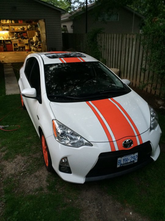

    Got bored and had some plastidip

    I like the racing stripe, the wheels? Not so much. ;)

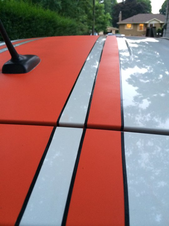

    Love it. How'd you get such nice pinstripes.

    Ive had 95% positive comments , everyone likes the stripe. one person didn't like the wheels.
    but ive had people from 20-73 tell me it looks great.
    I think it looks like a hotwheels diecast car now lol, which I lke
    For the stripes, I measured and found the center of the car and made pencil marks,
    then measured 5.5 inches off the center each way and taped.
    then measured andother 1.75 inches for the outside stripes.
    I did about 8 coats of plastidip.
    the final coat I did thicker and removed the tape immediately after spraying.
    then I bought two $5 packs of pinstriping, and put it along the edges and it improved the look a lot.

    +1 also nice work on the masking that's impressive.
