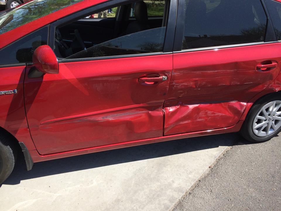

    Alas, I was involved in an accident. I was t-boned by a SUV. (Fortunately the harp was *not* in the car.) I am wondering how much it take to "total" a Prius? I'm afraid that the frame is compromised. This was the first new car that my husband and I had purchased and we tend to buy cars for long use. I am worried it will never be the same and do not want to spend the next 10 years or so driving a compromised vehicle.
    We did buy the supplemental insurance. So if the car is a loss we should be able to replace it with another Prius v. Any thoughts? Here's the picture:

    Ouch! Did the side airbags go off? Is it still drivable? I can't tell from the picture and it doesn't look that bad in the picture. I guess that's how much safer they're making cars these days. Once airbags go off and there is frame damage, most insurance companies will total the vehicle, especially if you can claim diminished value.

    The air bags did not go off despite the car getting pushed up against the curb somewhat. I don't think it is too drivable but the tow guy was able to steer its into place. The electric mode was still working. My thoughts are that it will never be the same and I worry about what would happen if it gets hit again. My inclination is to start over with another Prius if I can get the insurance companies to agree.

    Your instincts are right.
    I'd really want a new vehicle after an accident like that, with damage like that.
    Unfortunately might be right on the line as to whether they repair or replace.
    If they don't replace..and insist on repair, the diminished value claim is crucial.
    If they simply don't agree to replacement...then I'd want repair, diminished value, and then I'd trade in or sell and start over.
    Good Luck. Glad nobody was hurt, but too bad your vehicle is in such a state.

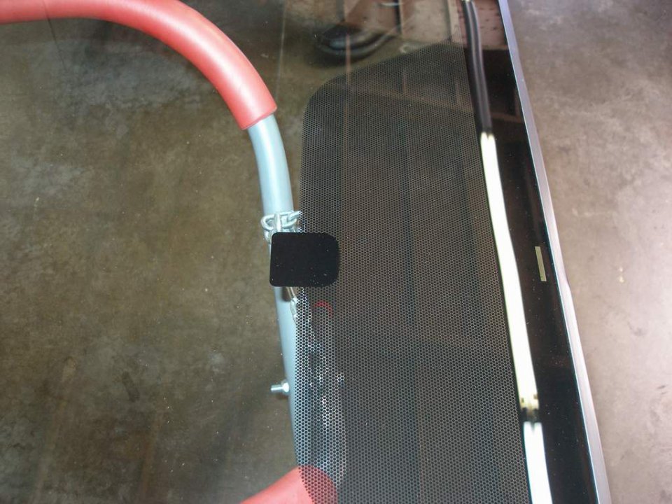

    This is a photograph of a Pilkington brand windshield, said to be a good quality aftermarket windshield. This was to be installed in my car last Saturday. They couldn't even get the rear view mirror mount in the right place. Is it not outside the dotted visor area?? Also, there were holes all over the black painted border.
    Below is where Prius liftback mirror mounts:

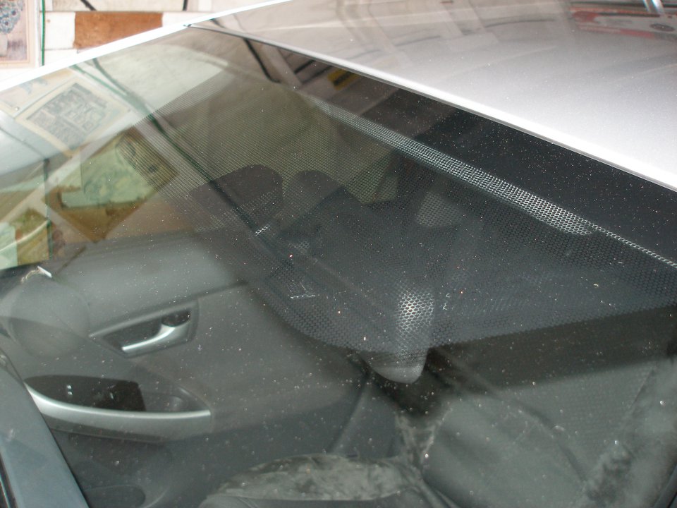

    This below is a proper Prius windshield for the non auto-dimming rearview mirror, clearly showing the mount wihting the 'third visor' area. Almost all Toyota windshield are mfrd by AGC corp from Tokyo Japan, that's Asahi Glass Company. If Pilkington can't even get a mirror location right, how could Tong Yang or a slew of aftermarket, knock off part companies get things like doors, bumpers, etc, etc ... right? Many parts probably do work, but I'll bet many leave you with crooked this and that.
    I know of a radiator mfr that makes cheap, made in China radiators that look like originals, but sell for like $60 to repair shops and come up leaking often and after short periods of time. You'd be surprised how many shops will stuff them in for repairs. new parts are new parts, yeah, sure.

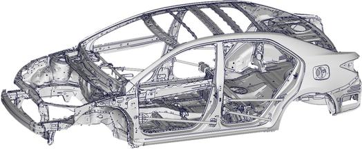

    They may be responding to your concern of wheel alignment. There are typically a front and rear subframe that the suspension components bolt to, and I highly doubt those were affected by the impact. They're called "subframes" because it isn't a true frame, it simply forms the support structure for the suspension.
    To get a better idea of what the "frame" is see below. I tried finding one of a Prius but was unsuccessful, but here's one of a new Corolla.
    It's mostly one piece. They can cut the welds and replace parts of it and make it good as new. Of course like cyclodrum mentioned some of that depends on whether they use OEM parts or not. Remember that structural parts are part of the vehicle's crashworthiness, and the repair standards are very strict because they would be liable for a substandard repair that caused injury.

    Speaking of aftermarket parts, look at post #7 in bottom link to see pics of Wavy Gravy made in China windshield put in my car yesterday. You won't see 'Made in China' stamped on the part. Mine says DOT 563 which stands for Shenzhen Auto Glass Co in PR of China
    look it up - DOT number search: DOT Number Database
    Toyota windshields are DOT 20, Asahi Glass Co, Tokyo Japan. Quality glass. Not wavy junk.
    It'll be out of my car next week, but really, I don't want techs repeatedly hacking on my car to replace. Who said 'new parts are new parts'. They are not even close to being all the same.
