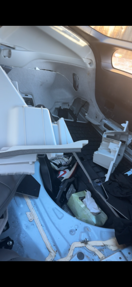

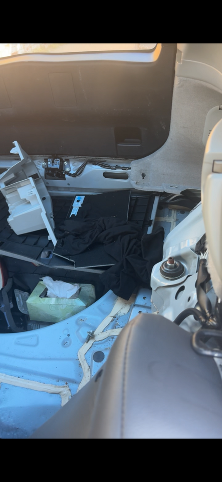

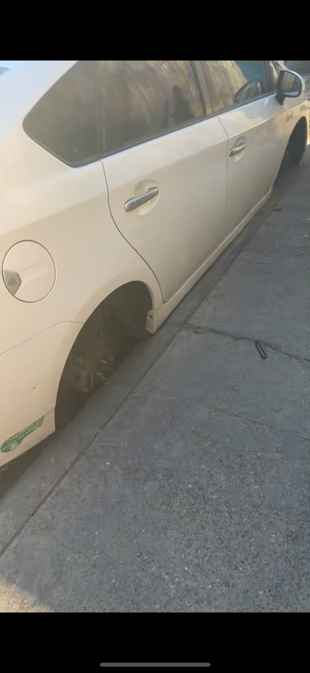

    hello all, couple of months ago my 2015 prius plug in got stolen from my driveway. Well I recently found the car but it is not in good shape. They have stolen most of the things from the back of the car: hv battery, cat, they have cut a lot of the wiring for the hv battery. They have the cut the frame wire. Luckily enough they were feeling generous and have not take the front end or body panels.
    After researching a little I have began to rebuild the car. I have put the frame wire back in from wrecked prius plug in. Next ill need to put back rest of the wiring, then the battery.

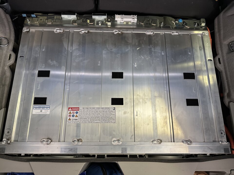

    I need a picture of a healthy 2012-2015 Prius Plug-in interior picture without the back seat and covers on the battery. Just an eagle eye view of everything. Let me know if some could help with that.
    I'll add a few pictures of the car when I get some time

    I have a 2012 Plug-in Advanced and will be glad to take those pictures.

    This is the first time I took apart the cover. Not as easy as the Gen 2 with many tight clips! :D
