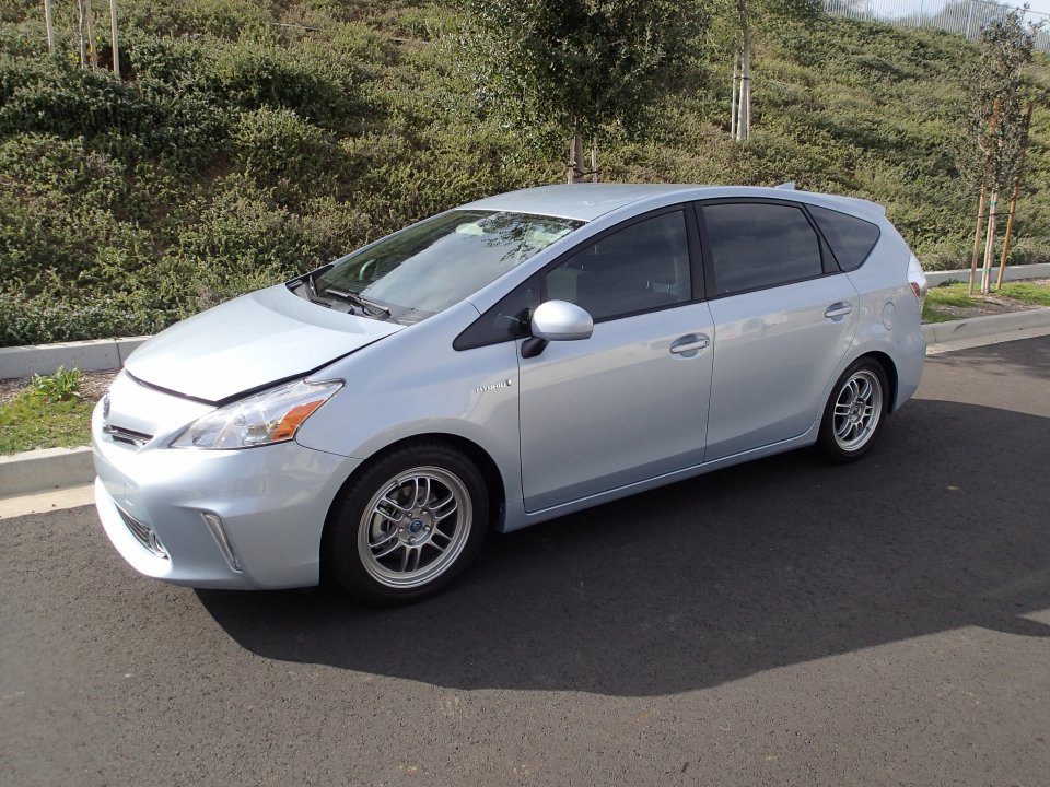

    PC240531.JPG PC240532.JPG I got my 2013 Prius v Two model in February of 2014. color: Clear Sky Metallic price: $24, 450.

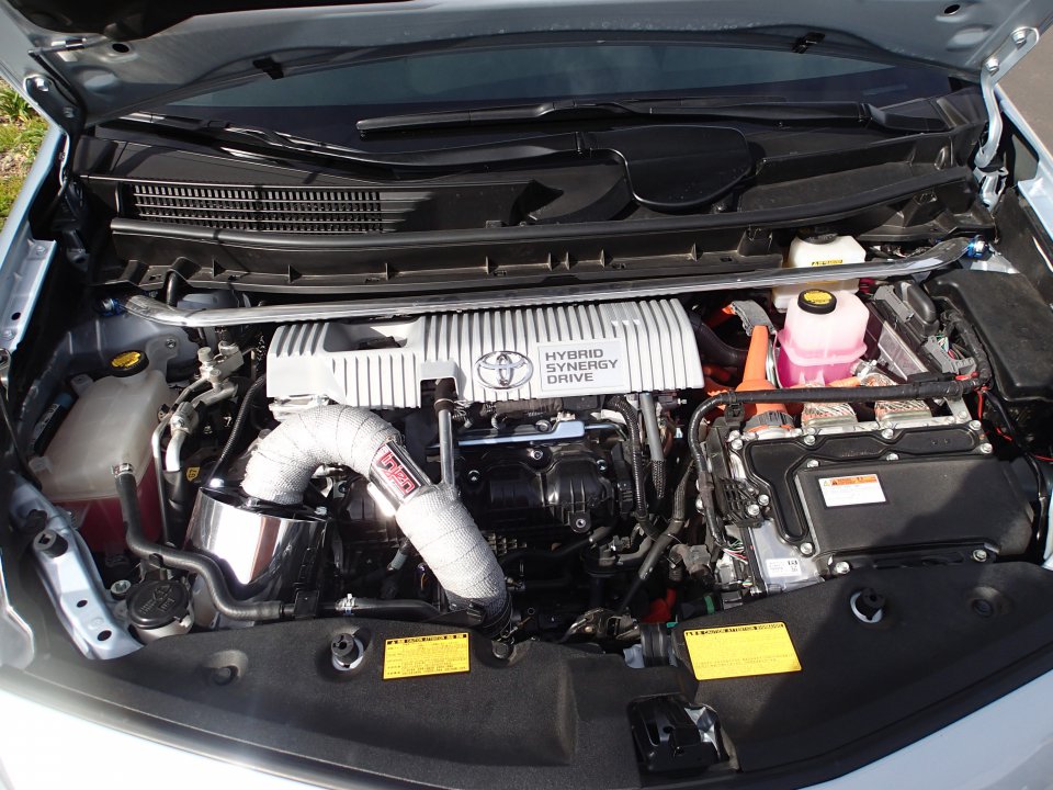

    > Cusco center chassis brace
    > Tanabe NF 210 lowering springs *
    > Cusco Strut tower bar
    > Cusco front lower arm bar (lower compliment to the strut tower bar)
    > Tanabe 2 point forward brace (Only for 2013 and later models. 2012 requires larger brace.)

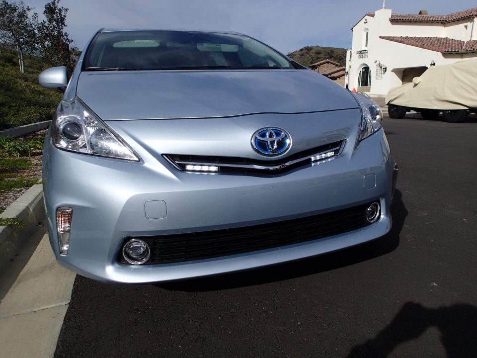

    - CREE daylight running lights (in lower slot of chrome grille area. From JDMToy) *

    > INJEN cold air intake
    - INJEN heat shield W/ Dynomat liner to deaden induction noise

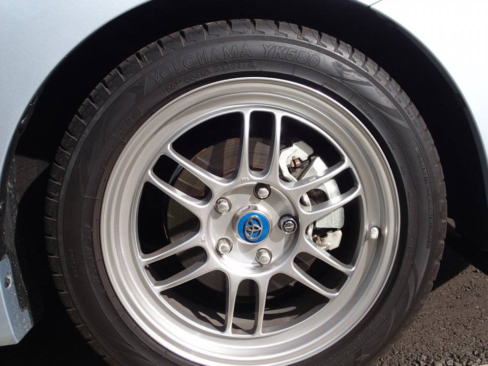

    - ENKIE RPF1 17" wheels W/ Yokohama 215/50/17 model 580 V rated tires (from Discount Tire)

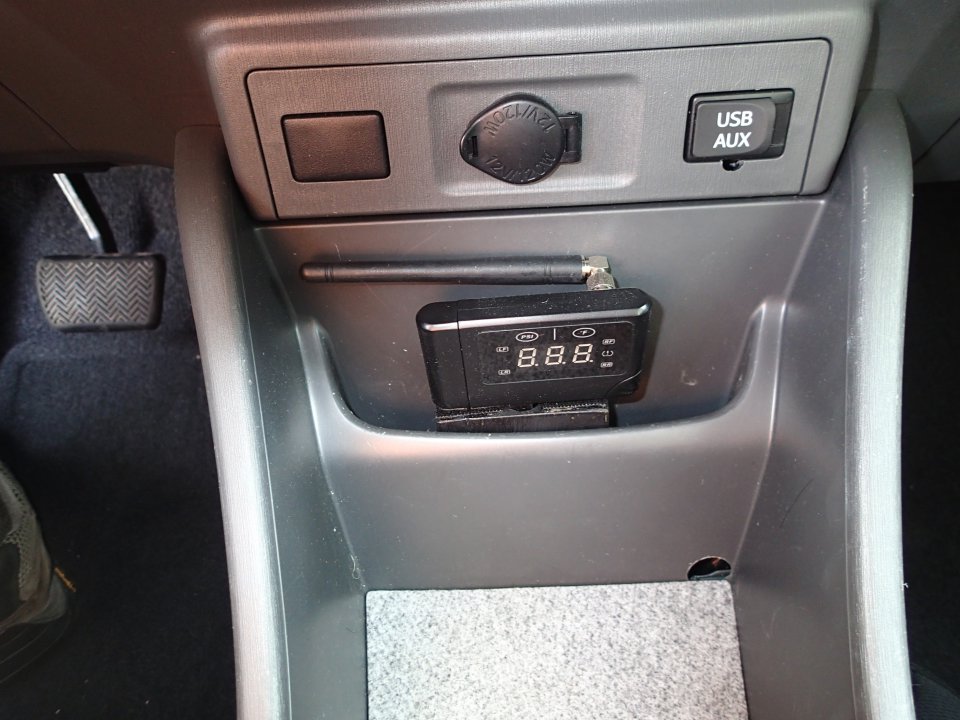

    - TPS upgrade (gives individual tire pressure and temps and location W/low pressure audible warning) *

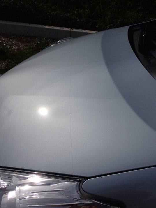

    - 3M clear protective film (Entire front including 1/2 of hood, partial front fenders and rear view mirrors) *

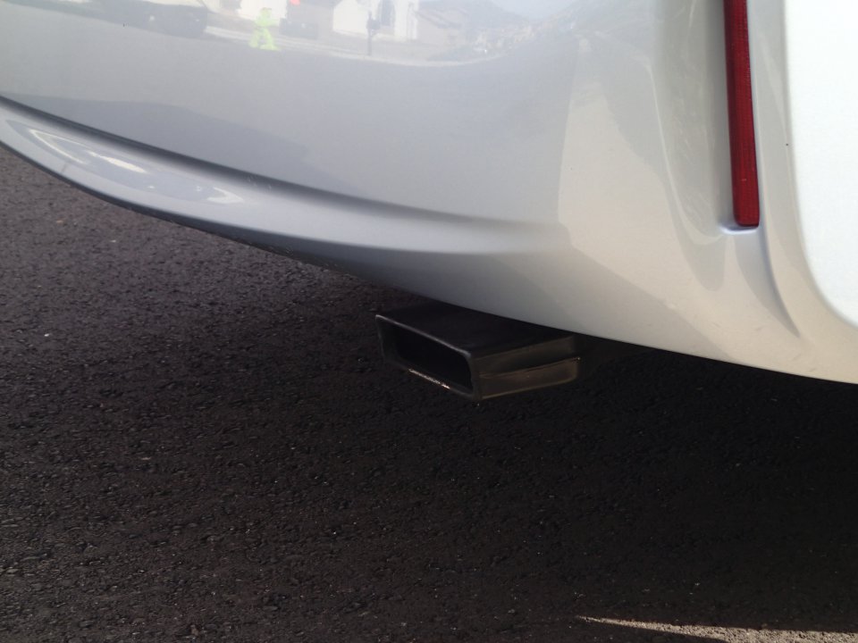

    - black coated stainless steel rectangular exhaust tip *

    I run Yokohama YK 580 (Discount Tire's own tread design/model designation) 215/50/ 17" on ENKIE RPF1 rims, the lightest I could find.
    The Yoks are V rated B/C I live in the Mojave Desert and need the high heat rating when bopping along at 75 - 85 mph.
    These tires have Yokohama's "Orange Oil Compound" for better wet weather traction and fuel mileage.

    I've got 3 Cusco braces including a strut tower braces. Soon I'll have a 4th brace (front underbody). All are from Juiced Hybrid in Redwood City, CA. The underbody braces are chrome moly steel flat tubular, the strut tower brace is aluminum W/ steel end plates.
    All are Japan sourced and fit perfectly. What a difference in handling!

    1.Go to JDMToy LED Daylight Running lights page
    2.click on "UNIVERSAL daytime running lights" in the box at left
    3. The new page shows a large selection of non-custom lights
    They are the Universal LEDs shown on a Range Rover (upper right of the light ads).
    The title is:
    "Xenon White Universal Fit Daylight Phillips Style 4
    LED HighPower Cree LED" the SKU is 60-006
    "V+ instar" is the brand name. They have cast aluminum finned housings for heat dissipation and everything is high quality.

    FYI, "rated at 7000K" isn't an indication of brightness, but on color temperature. A 7K or 7000 color temperature, would make them bluish in color.

    Yep, you would think that they would be slightly blueish at that temp rating but they are actually just bright white with no bluish tint.
    Check the JDMToy site for the lumens rating.

    OK, Got the Tanabe 2-point under brace and installed it today. I cut 0.5 cm off the bottoms of the end cylinders and painted it Cusco blue to match the other two braces. (I know, who gives a $hit? It's under the car. ;o)
    This brace, joining the new style 2013- 2014 Toyota triangular braces, will make the chassis a bit stiffer with negligible weight, being internally reinforced flattened tubular aluminum. Gotta be better than the steel braces that Toyota used further back where my center brace now resides.
    That's it for braces. One pi-shaped Cusco center brace, one Tanabe 2-point brace, one Cusco front lower arm brace and one Cusco strut tower brace. The Cusco "rear-end" brace Juiced Hybrid offers is totally unnecessary.
    Now for the Tanabe front and Cusco rear sway bars and I'll be done with suspension upgrades.
