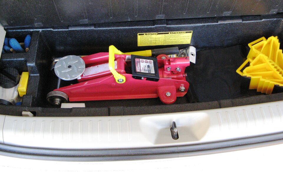

    Over the years, I carried a Harbor Freight aluminum flat top 1-1/2 ton racing jack. The original was bulky and weighed 23 pounds. Unfortunately, while Toyota provided a strap and instructions on how to hold down the full sized spare on top of the rear compartment platform, there was no way to tie down the Harbor Freight jack to keep it from flying in case of an accident.

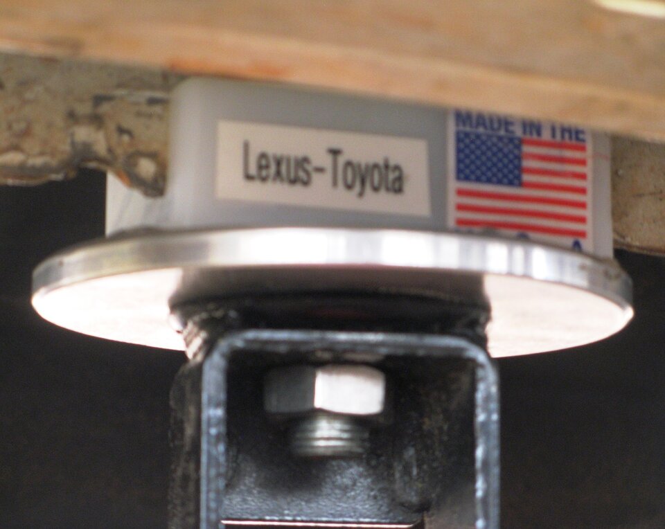

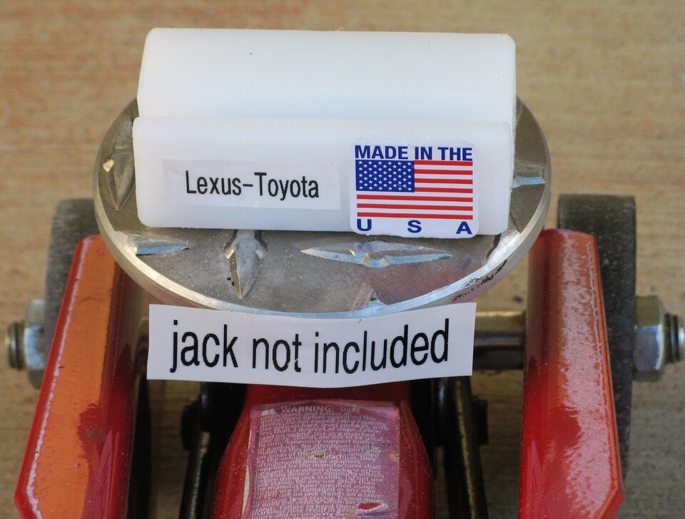

    I had developed and made various versions of pinch weld adapters for the flat top jack over the past 12 plus years with good success.
    I was always concerned with the clearance under the pinch weld jacking point with a completely flat tire. That was the reason for the Harbor Freight low clearance racing jack.

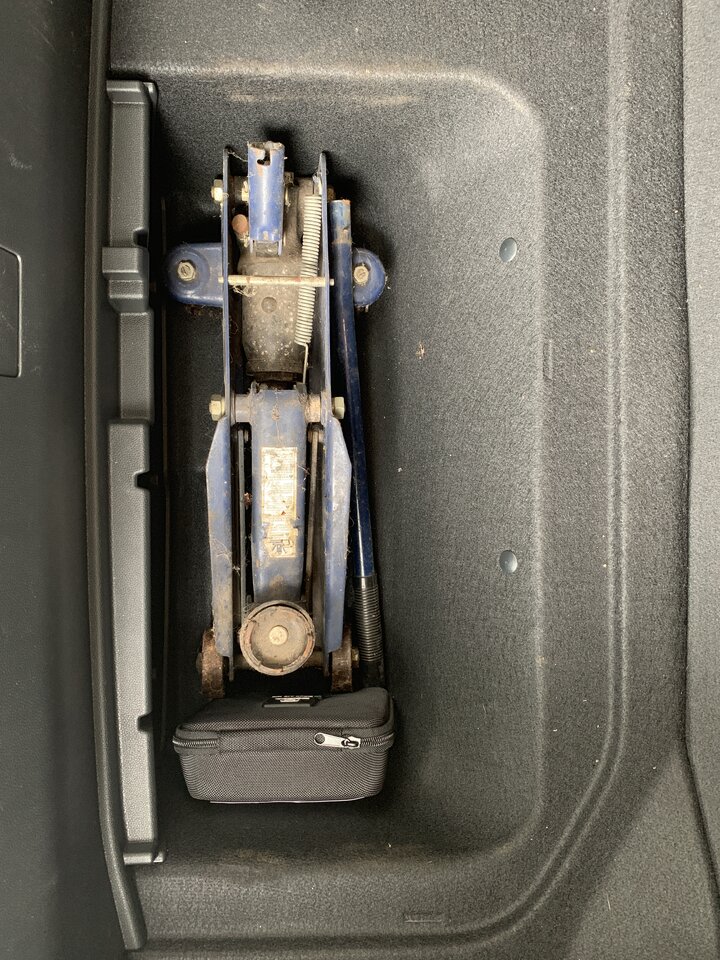

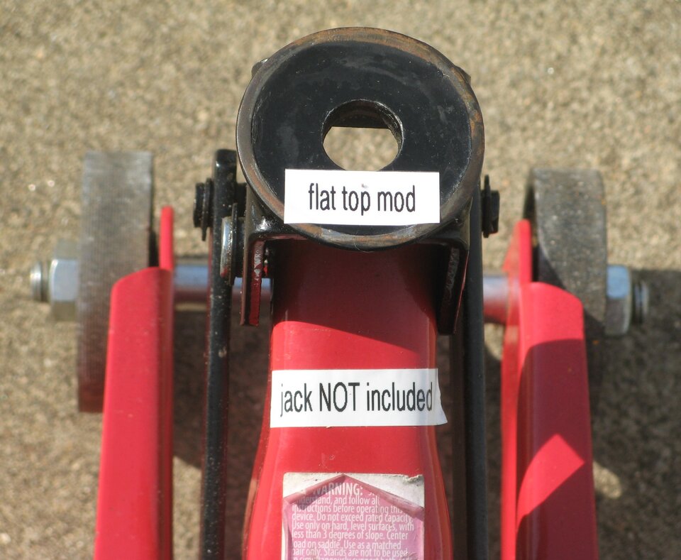

    To my surprise, the Walmart Hyper Tough jack is amazingly easy to carry in one hand with the top handle and stores well completely and safely under the hinged panel of the cargo area foam insert.
    My only concern was that the lowered height of the jack was over four inches and might not fit under the pinch weld with a flat tire and the stupid little cut swivet top of the jack.
    On that account I carried a low rise ramp and made a flat top adapter for tTo my surprise, the Walmart Hyper Tough jack is amazingly easy to carry in one hand with the top handle and stores well completely and safely under the hinged panel of the cargo area foam insert.
    On that account I carried a low rise ramp and made a flat top adapter for the jack.
    Monday before last, I visited the local Lowe's and when I left the parking lot, I heard a flapping noise as I drove off. As I went to the parking lot of the Home Depot across the street, I looked at all the tires and found the right rear tire to be totally flat.
    Using the Ryobi inflator, I could not get the pressure to go above 5.5 pounds. That told me that the tire needed to be changed.
    I was happy when I found that the flat top converted Walmart jack had over an inch of clearance under the pinch weld with the car lowered by the flat tire. Having more than enough clearance, I slid the pinch weld adapter under the flat top of the jack, jacked up the car and changed the tire.
    I no longer need to carry the low rise ramp.
    I have uploaded photos of the flat top converted jack and the pinch weld adapter as I used it.
    flat top jack mod.jpg installed wo rubber.jpg on trolley jack lowered.jpg on trolley jack raised 2.jpg on trolley jack raised.jpg

    The jack does not bounce around in the cargo area. It fits conveniently in the foam lined well under the top cargo floor.
    In the Prius v, the entire top floor panel and two long awkward slender foam storage pockets have to be removed to access the donut spare and scissors jack.
    In my case, the full sized spare is held to the top of the cargo area flat floor with the Toyota supplied full sized tire retention strap.
    The full size spare is retained forward enough that the hinged part of the floor can be swing up to quickly pull out the jack from the foam lined weĺ.
