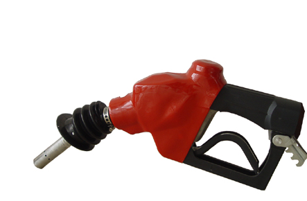

    Probably (a). Go to the station, and fill up. However don't use the auto stop. Also if you are in a state with those venty things on the pump, flip it upside down or wedge something between the capture nozzle and the air. Fill it up by squeezing the handle so slightly that barely anything is flowing. Continue to do so until you hear it near the top. Like filling a water bottle, it makes a different sound near the neck.

    I have no idea what venty thing you're talking about. Are you just saying pump it slowly?

    It is the vapour recovery nozzle. The black accordion thing on there, and again only in some states.
