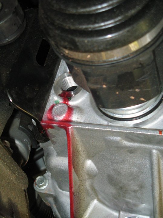

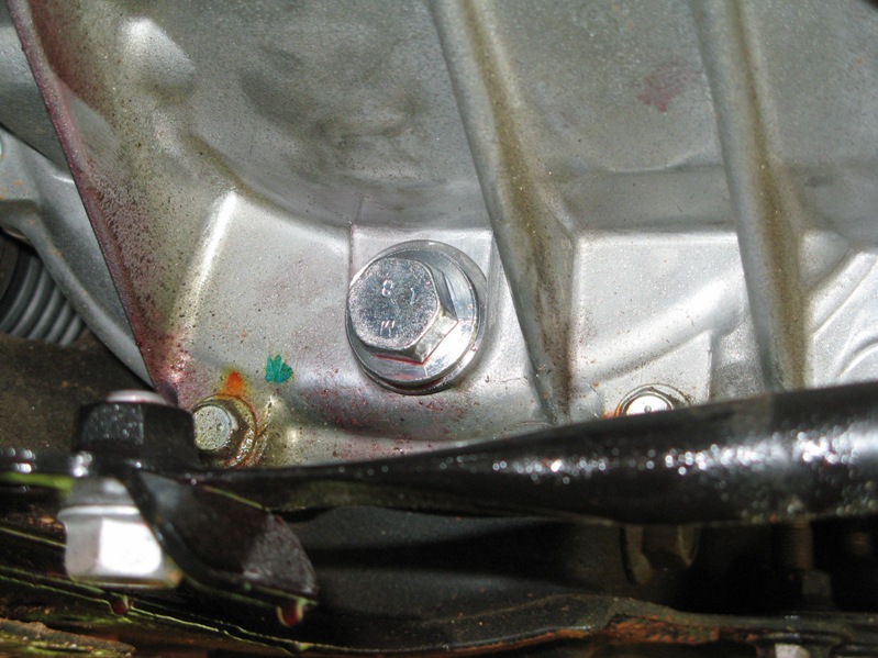

    Today, I drained and refilled the transaxle in my Prius"v" with 13.090 miles.
    With every NEW car or vehicle that I've purchased, I've always changed the automatic transmission fluid at about 12.000 miles.
    That, I did, today with my Prius"v."

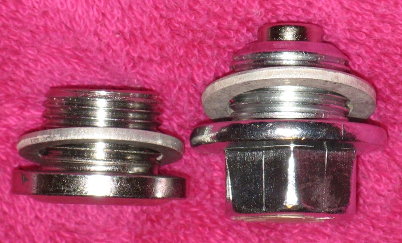

    Contrary to pictures provided by others, there is no small ceramic magnet in the lower drain plug.
    The fluid was quite dark, but NOT burnt, like I've seen in other transmission fluid changes.

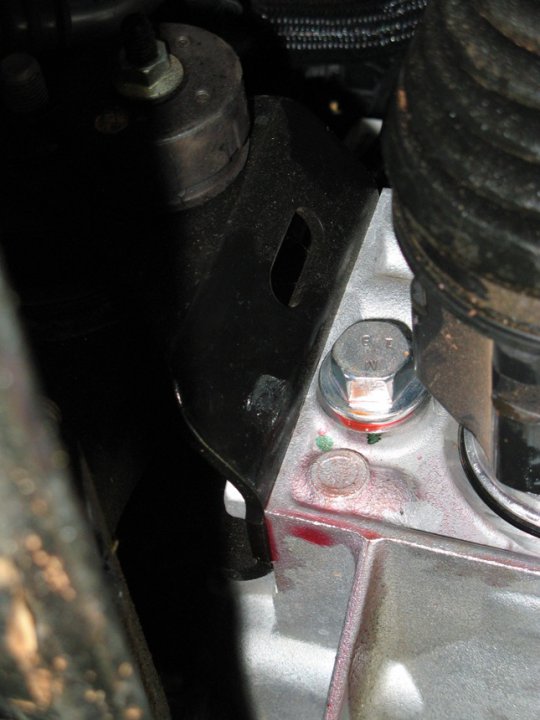

    I've always hated Phillips screws and hex socket headed screws like those o a lot of European cars like BMW. Unless you have the wrench fully seated in the socket and perfectly centered with the axis of the screw, you are likely to destroy the socket. This happens especially with frozen or corroded fasteners.
    The shallow hex 24mm head on the Gen II fill plug is NOT the answer. A 24mm socket and wrench is NOT a common size in a regular tool set.

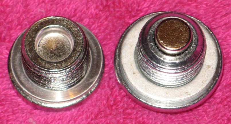

    Searching far and wide for nearly six months, I finally found a US made plug with a full height 19mm or 3/4 inch hex head on it. To trap the iron and steel particles coming off of he gears, I bored out the center on my machinist lathe and secured a 15 pound pull N45 high grade neodymium rare earth magnet with green 640 Loctite. 640 is the Loctite used to lock cylinder sleeves into engine blocks.
    Now, I will always be able to remove and install the plugs with no worry of ever stripping out the heads.

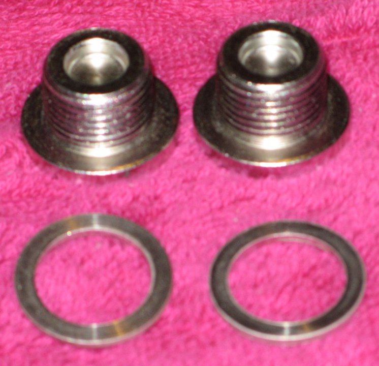

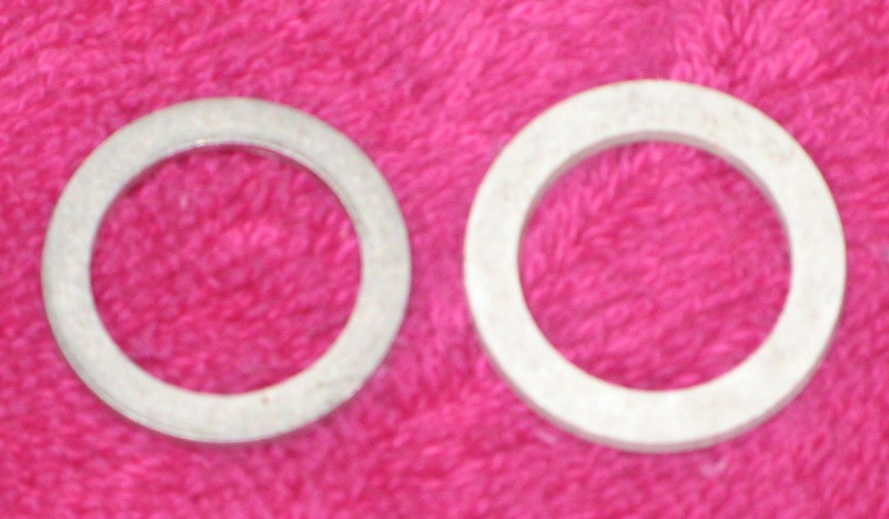

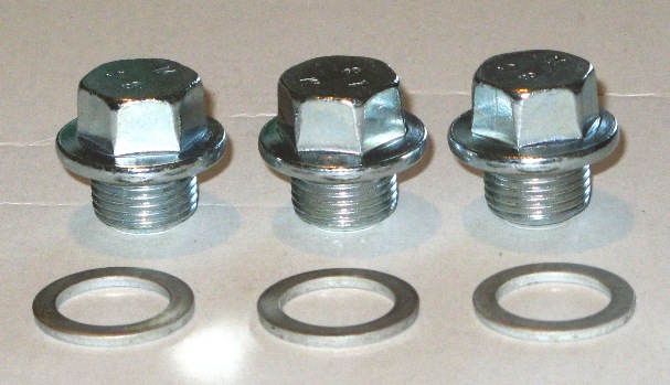

    I did extensive research in deciding on the plugs for this project. I chose Made in USA plugs that are of much better quality than the Chinese made ones. From my experience with fasteners and their manufacturing methods, the plugs I sourced have machine "rolled" threads, which are stronger than the die "cut" threads on the OEM plugs. "Rolled" threads are "cold forged" and work hardened.
    I sourced aluminum crush washers that are the same 2mm thickness as the OEM ones but 1.5mm larger in the OEM ones for a larger sealing surface.

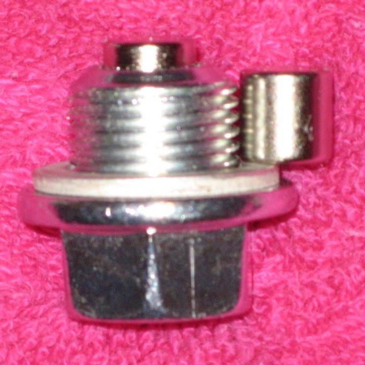

    There is one inline vendor that just glues a large neodymium magnet on the end of an OEM plug and sells them for $19.95.
    My plug is machine bored to hold a large imbedded magnet, as shown with the plug compared to an uninstalled magnet.
    I have uploaded more photos that are self-explanatory.

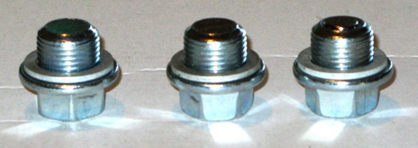

    I have decided to make up a small quantity of three piece sets, since the ECU coolant drain plug uses the same thread and gasket or crush washer.
    These will fit the transaxles on ALL Prius models from 2004 to the 2015's. That includes all Prius liftback, Prius "c" and Prius"v."
    Once installed, servicing the transaxle fluid and draining the ECU coolant will no longer require a 10mm hex wrench and/or an extra large 24mm socket on the Gen III Prius.
    All that will be needed to remove ad reinstall ALL the plugs is a 19mm or 3/4 inch socket.
    The transaxle drain plug will have a large 15 pound pull N45 rare earth neodymium magnet imbedded into it locked with Loctite #640.
    Each plug will include a NEW aluminum crush washer, three in all.

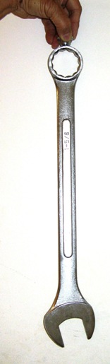

    I tested the magnet I the drain plug to see how much holding power it had. The magnet held a 1-5/8 inch standard size jumbo combination wrench with contact made to the very small area of its curved surface.
    So, it is likely that it will catch most all of the iron and steel particles worn off of the transmission gears and parts.
