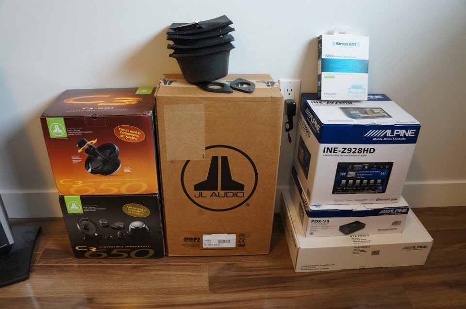

    Here is a list of everything I’ve purchased:
    Alpine INE-Z928HD
    Alpine PDX-V9 5 channel amp
    Alpine Perfect Fit Prius Faceplate

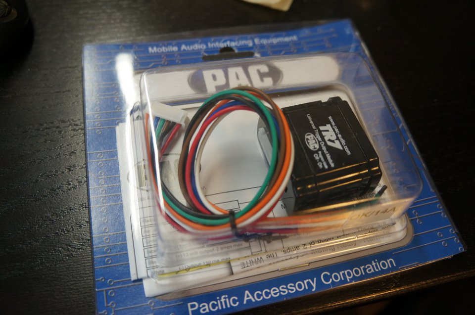

    TR-7 module to override head unit parking brake lockout
    Sirius XM add-on receiver
    JL audio C3-650 Component speakers x 2 pairs
    JL audio 8’ Microsub
    Foam speaker baffles x4
    Tweeter mounting plates x2

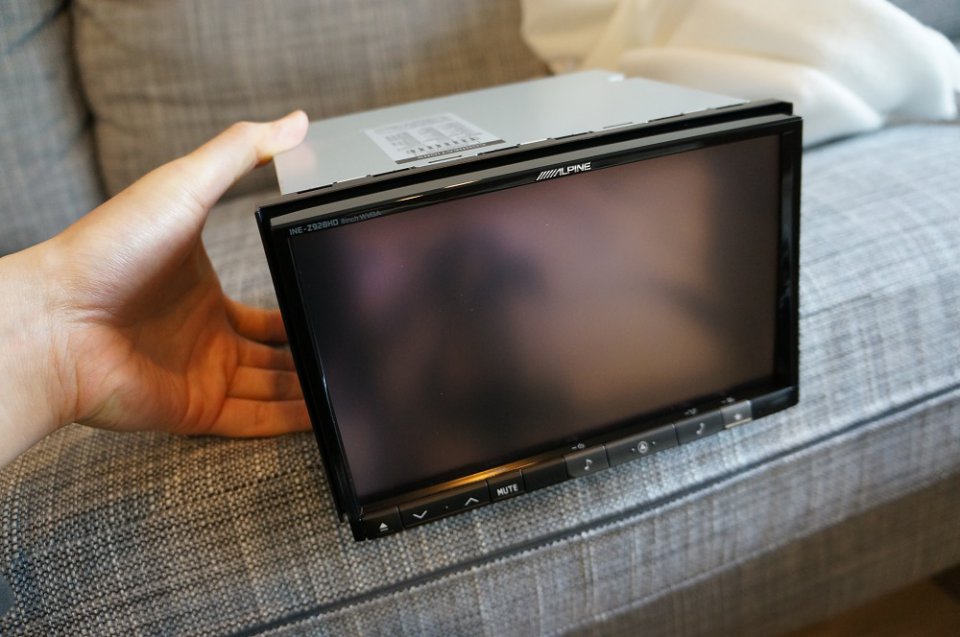

    The Alpine head unit is a massive 8' LED screen. This was the most expensive piece of the system and I was cautious of buying it from private sellers on ebay or amazon. After all, if anything could break down in a sound system, it would be the head unit or amp. Luckily, I found it on Crutchfield.com (a reputable dealer) on clearance for $1099. Usually internet price is about $1299 or more. There is a FEB 2014 manufacture date on it which makes me happy as the unit is quite recent. It was on clearance because Alpine is releasing their generation 2 8' display this month. I am happy with Crutchfield's customer service and business ethic. I am really looking forward to using the GPS on this system as well as take advantage of it's DVD playback capabilities. Most importantly, I will conveniently have music from my portable plug-in USB drives so will have access to more music on the go.

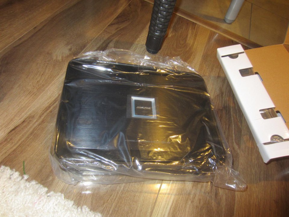

    This is Alpine's PDX-V9. A very slim class D amp with more than enough oomph to power the entire system. It came from Amazon by a reputable merchant including warranties.
    In case you are wondering about the specs, here is the birth certificate of the amp.

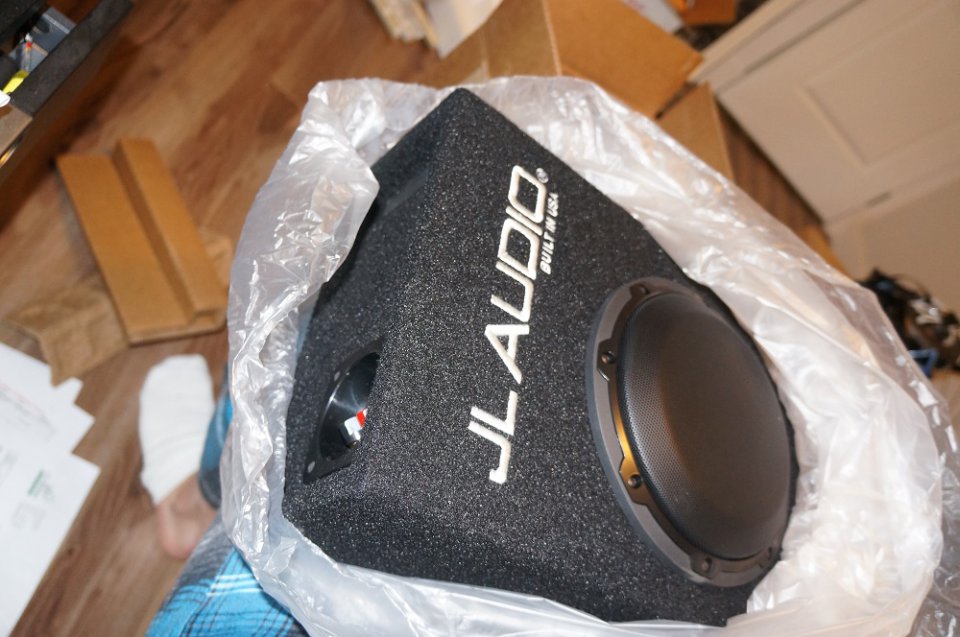

    Here is the JL audio 8' microsub. Very slim profile. I am not a kid anymore so don't need two 12's in the trunk. Also I don't listen to gangster rap and I am not one of those idiotic college kids that roll down their windows so everyone down the street can hear their bass. I usually relax with classical music and occasionally some trance; a very odd combination. LOL. Nevertheless, I just need a small sub to reinforce and underpin the bass notes in the music....Not wake up the neighbors and set off car alarms in the parking lot. The slim profile of this box will let me tuck it away underneath the trunk lid; away from prying eyes. Perfect.

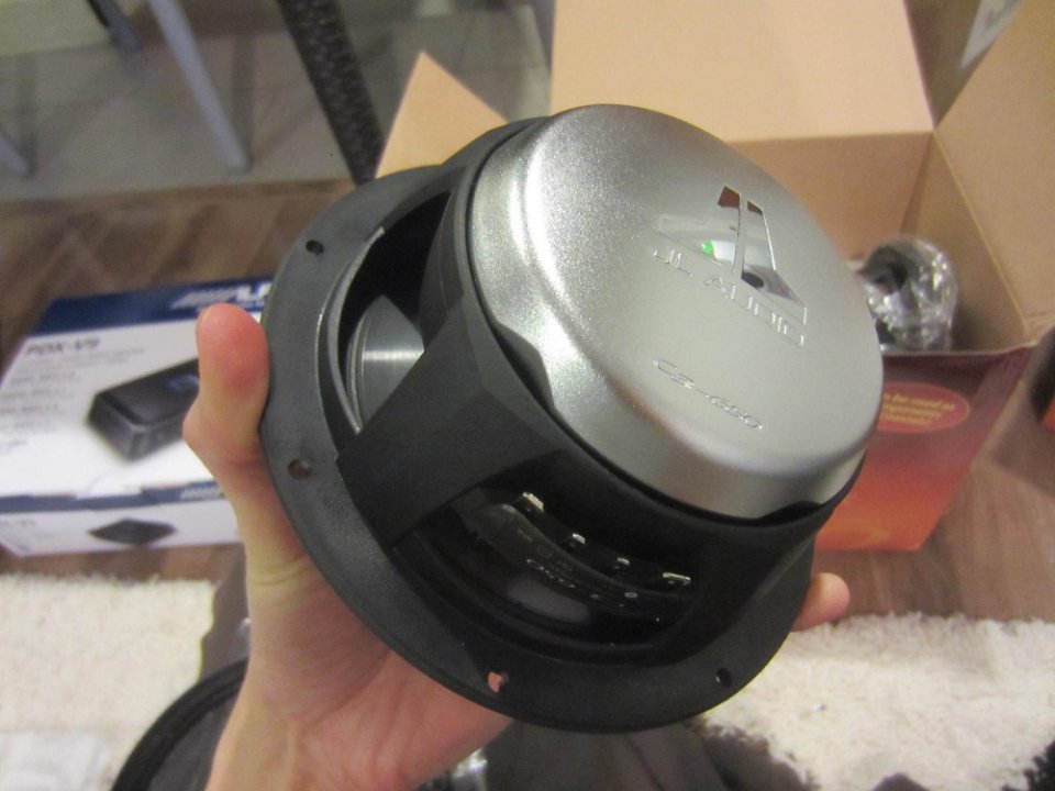

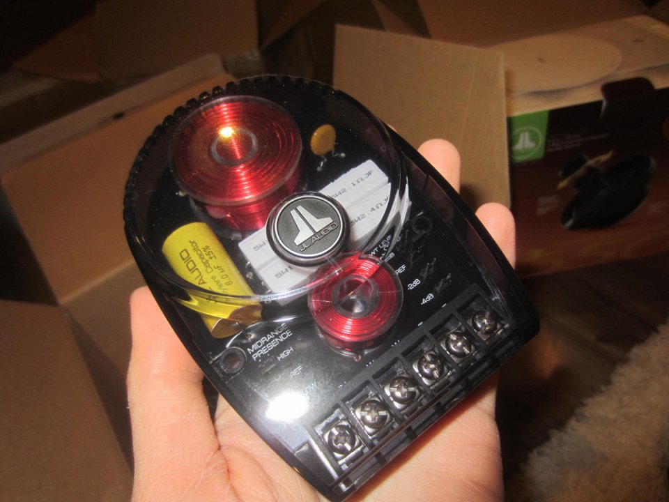

    The JL audio C3-650's are beautifully made. It's a pity that these won't be visible once they are installed.
    I will have to deal with installing 4 crossovers into the car.

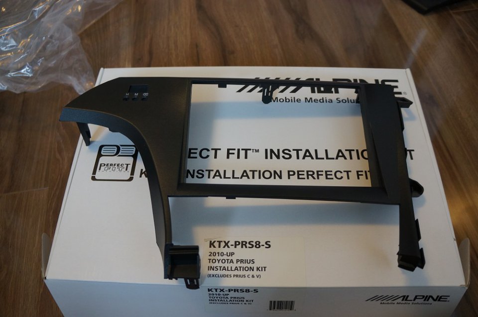

    Here is the star of the show and the icing on the cake - This faceplate will allow the fitting of the huge 8' screen and tie everything in; making the stereo look OEM.

    Yes, the trim replaces those buttons beside the screen. Those buttons control stereo functions like eject, radio tuning, skip tracks etc. Alpine screen is touch sensitive so you can tap the screen to access the same thing.

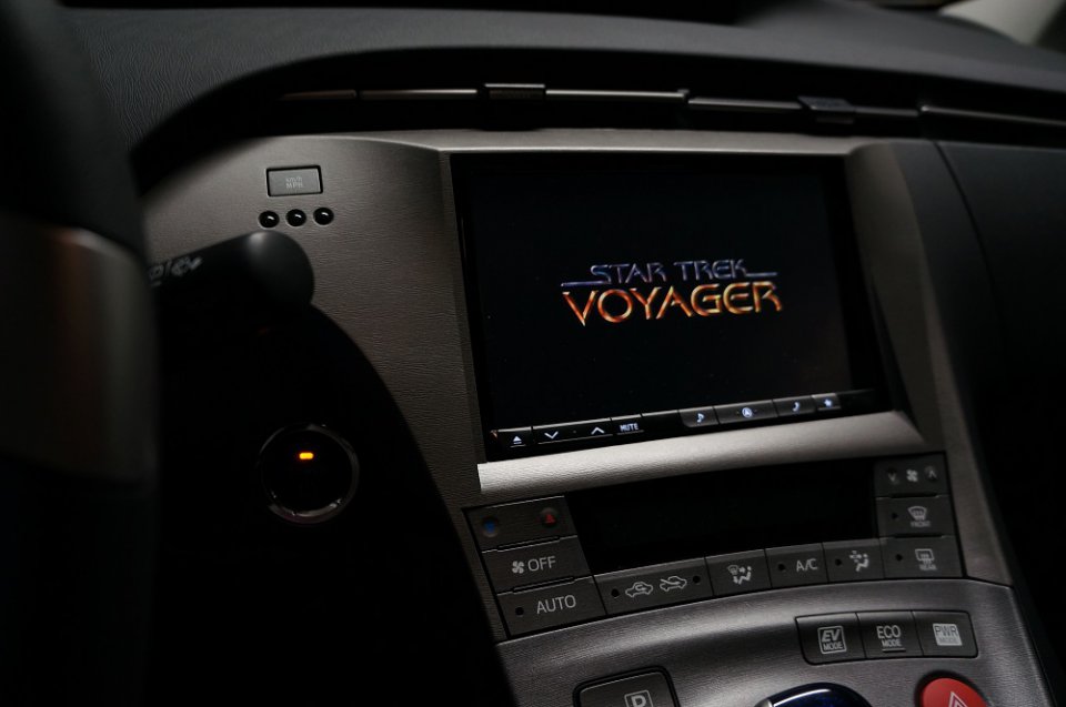

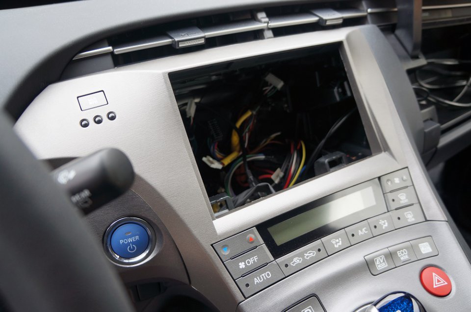

    I had the black Alpine bezel color-matched to the same shade as the gunmetal trim - it is almost a 100% perfect match. It is depressing at the moment to stare into that gaping hole in the dash.

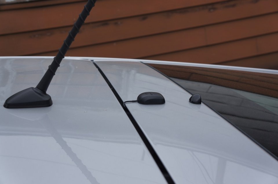

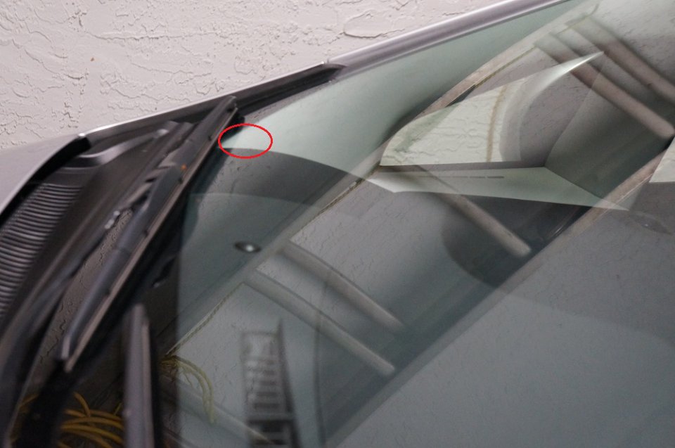

    The GPS antenna is hidden underneath the plastic trim at this location. It still faces up towards the sky and the installer said the plastic trim won't affect the GPS signal - lovely! As I am looking for a nice clean install. DSC00005.jpg

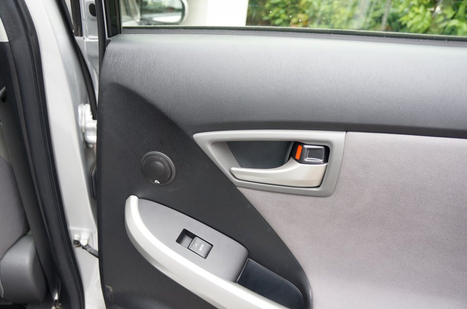

    Tweeters integrated nicely onto rear door trim. The tweeter surround color matches the interior trim and the low position of the tweeter relative to the door makes it less visible to thieves. Although less closer to the rear passengers ears, the instruction manual states that when the tweeter is closer to the woofer, there is better integration of stereo sound. Good job here too! Regarding the front tweeters, they are mounted into the stock squaker locations for a tidy install.

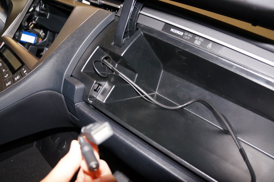

    The head unit has USB connections for a thumb drive etc. I requested the connectors be routed thru the upper glove box. It's a seriously long cable and the whole setup is the only eyesore in this install but it will have to do. At least it is hidden from view when the glove box is closed:
    Originally I requested the crossovers to be in the trunk where they could be seen. Then the plans changed and the units were supposed to be mounted into the door frame behind the vapor barrier. Without consulting me, the installer ingeniously mounted them hidden away in the body of the car somehow (which is a very good thing) I found the two front ones sitting in a pocket at the front corners of the car. I am pretty amazed how this was done. Two thumbs up! Now I don't have to worry about moisture damage for units. I have yet to see where the rear ones are located. Also I see that connectors are color coded and decent quality wires are used in the install. More thumbs up

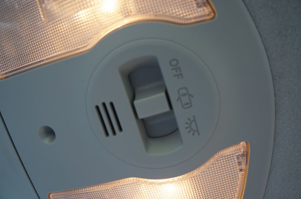

    The included alpine bluetooth mic was installed in the original location of the OEM mic. This is WAY better than having the mic visible on the dash or sticking out of the headliner. Kudos to the shop for keeping it clean and tidy. Apparently, the OEM mic could not be re-used due to performance concerns

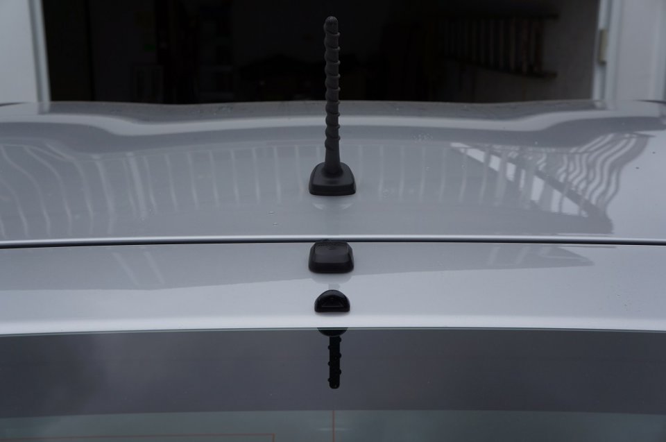

    I requested the Sirius XM antenna to be located behind the factory AM/FM antenna. The headliner had to be removed so this added much more cost to the install job. Looking tidy and seamless here.

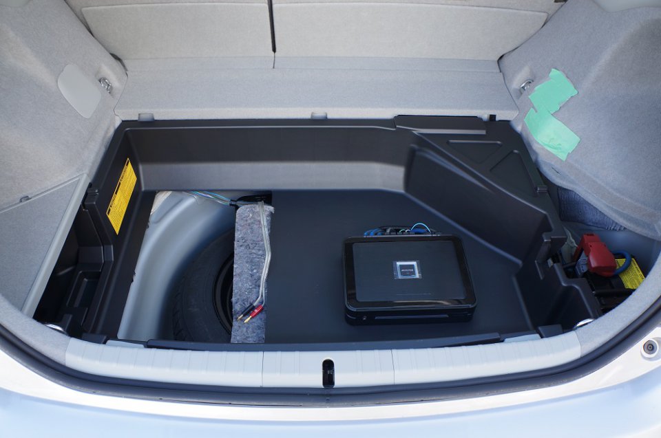

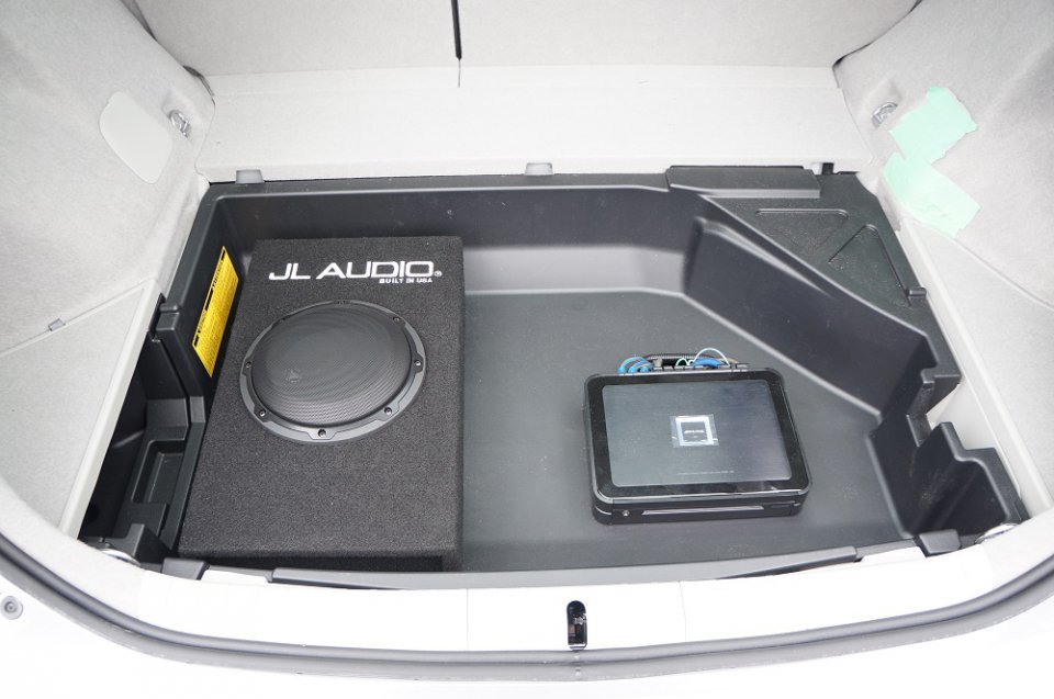

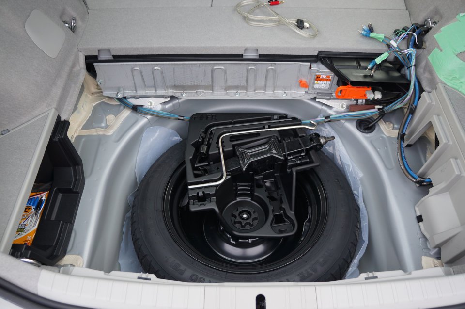

    Here is the sub and amp hidden in the trunk. The amp is reinforced with MDF on the back. A hole was cut out in the plastic trim to accommodate the sub. The sub can wiggle around by a few millimetes but can't slide during hard cornering. I would have liked a custom shelf built to fit the spare tire area perfectly with carpeting, a plexiglass panel to see the amp and crossovers to display but that alone would have costed thousands for the work to be done. This will have to do.

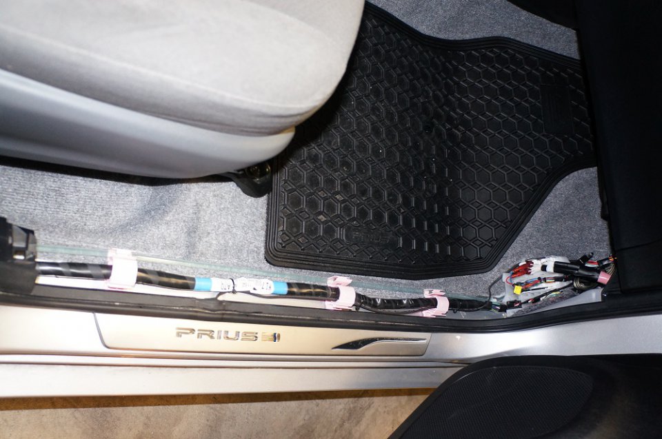

    All wiring neatly wrapped and routed through the car:

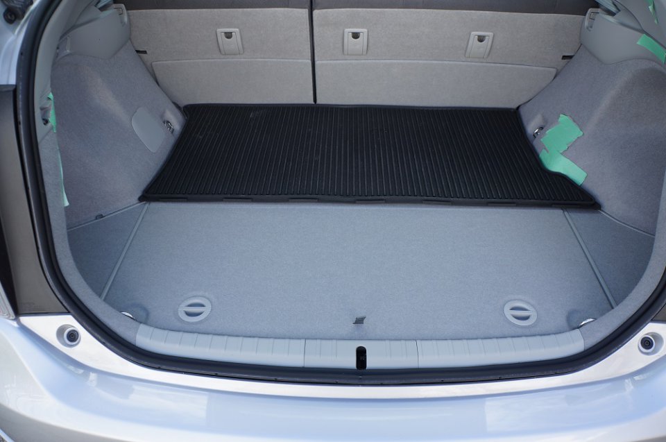

    The subwoofer pulls out easily in case the spare tire needs to be accessed. Then the whole OEM shelf can be tilted upward. Pretty simple.. pretty rudimentary without any bling, but does the trick. It will have to meet my goal for cost, practicality and functionality.
    And here is with all the panels back in place. Neat, tidy and out of view. Perfect.

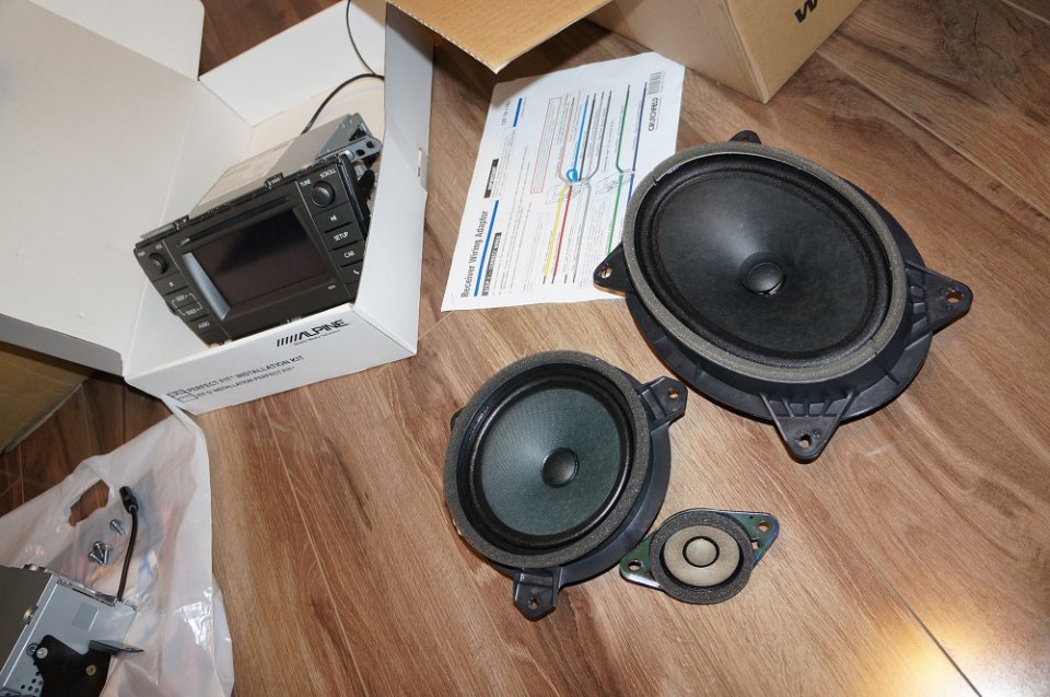

    The OEM speakers are just totally awful. I have never ever held in my hand such cheap and lightweight speakers in my entire life!!!!! The magnets are ridiculously small, surrounds are foam and the cones are paper. True, the Prius is an economy car and probably all the R&D for the vehicle went into the Hybrid drivetrain but I am just having a silly guess that the speakers here probably costed Toyota less than $5 each unit:

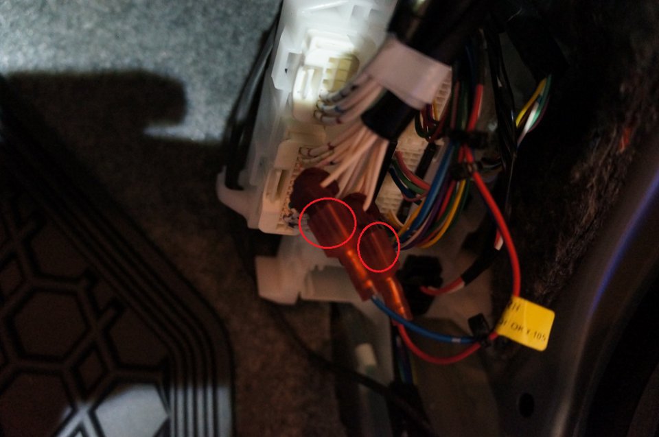

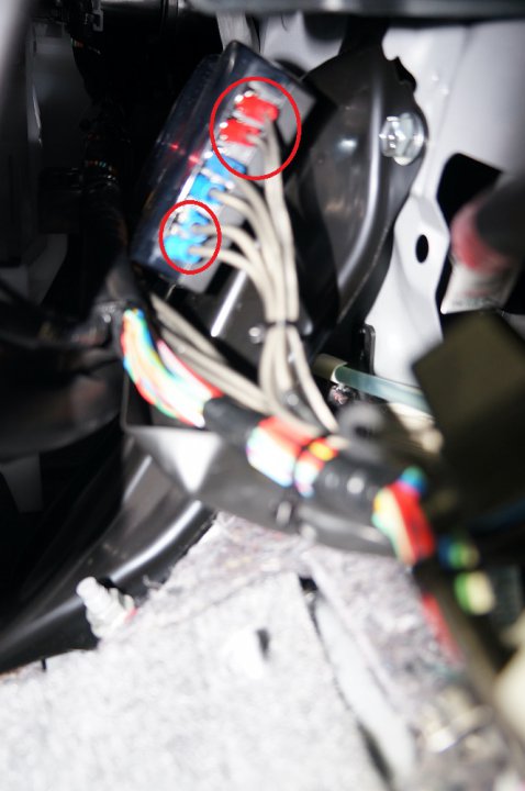

    When I got home, I noticed that my LED side sills were not working. Oh oh! Did something get shorted out during the time the car spent in the shop? I ripped out some panels to have a peek - I installed the side sills myself so can look at this mix of wires and see what is going on.
    It looked like the cheap OEM connection here wiggled loose from the head of the connector. I may somehow tape or shrink wrap this connection since I don't want it wiggling loose again in the future.

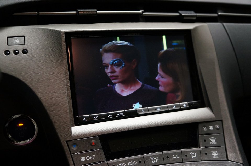

    I have found two more problems now that the head unit is installed. The DVD playback is not showing an image (although there is sound) and the steering wheel controls don't work correctly when the car is on ACCESSORY mode. In ON mode, they work fine.
    Will post another entry in a few days time where there is progress.
  17. Grren4ever
    Grren4ever Active Member
    Sep 29, 2013
    347
    167
    Hi everyone,
    Thanks for bearing with me on this repetitive entry - After receiving a replacement head unit from Crutchfield, The system is up and running, and complete! The PAC TR-7 video bypass which I bought for $17 on ebay was defective which did not allow my unit to play a DVD.
    Another PAC TR-7 was swapped in and everything is working fine:
    Just a note that I don't intend to watch DVD's while I drive but it is meant for long road trips where passengers get bored!
