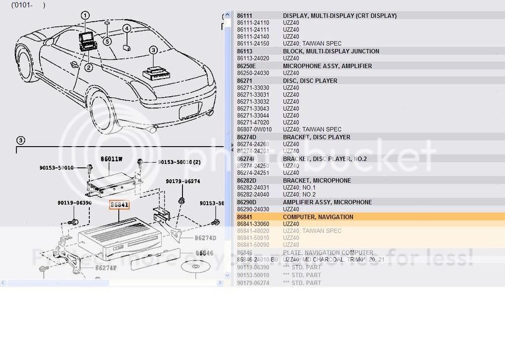

    It might work since one of the part number are match, but the part number you have is taiwan spec.

    Look on Craigslist or Kijiji or ebay. Do not buy from the dealer as they are refurbished units anyway, and at that price its way too much. I know, that is exactly what Toyota told me. I got mine on ebay for $400!!!
    The 47020 unit will serve as an adequate replacement, and was a US model unit (it still uses Canadian maps, I can show you pictures of my 47020) in my 2002 Prius if you like!

    Oh and here is a list of vehicles that will apply to your vehicle
    2001-2003 Lexus LS430
    2001-2003 Lexus GS400
    2001-2003 Lexus SC430
    2001-2003 Lexus IS300
    2001-2003 Lexus RX300
    2001-2003 Lexus LX470
    2001-2003 Toyota 4 Runner
    2001-2003 Toyota Landcruiser
    2001-2003 Toyota Prius
    Just look for any Generation 2 or 3 navigation system, both will work just fine in your Prius!
