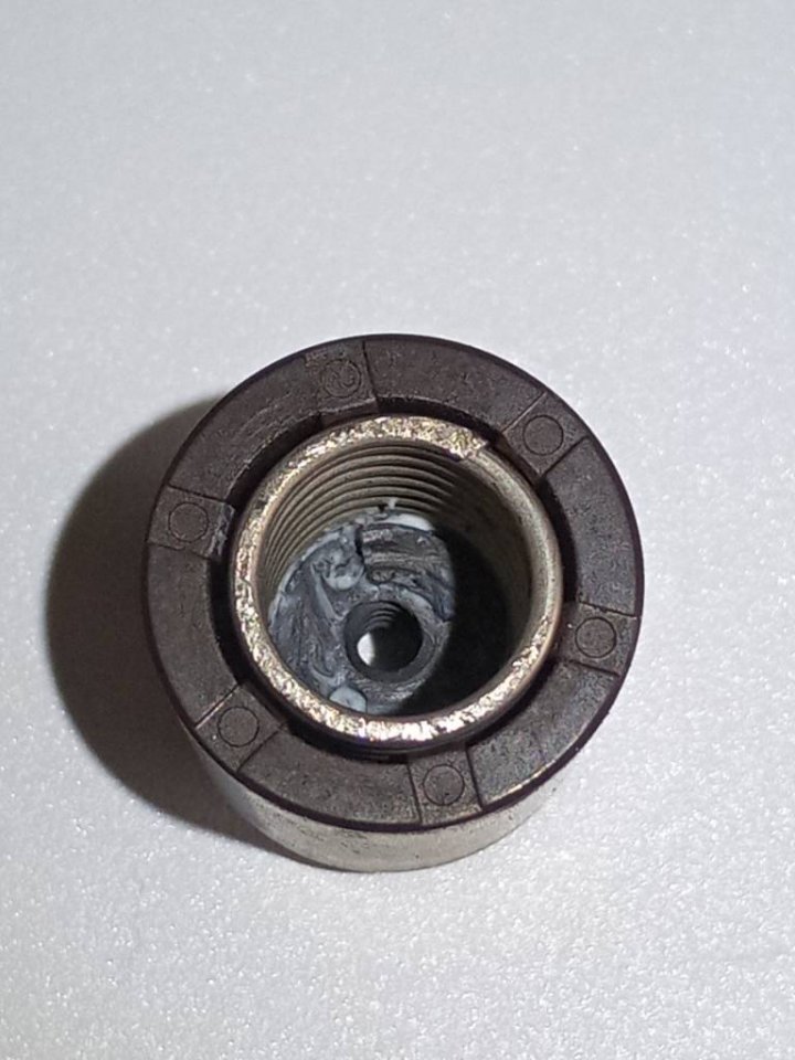

    Here's where I'm at:
    Not seeing any obvious means of going further, getting the valve completely out, for a more thorough cleaning.
    See a little brass tab under the bearing, a clue?
    see also, there’s a couple of opposing flat zones along valve stem.

  2. Paladain55
    Paladain55 Active Member
    Oct 20, 2021
    409
    168
    The South
    not extremely necessary to take it out, you can clean the valve with it in. clean in and around push down on it etc...
  3. Mendel Leisk
    60,886
    41,905
    I've done that (first time around, five years back), and mostly agree. Still, it was assembled, so hopefully can be taken apart and reassembled. The brass tabs info/pic I've now added to initial post may be a clue.
    And I appreciate these things aren't cheap, don't want it springing apart like a Swiss Watch, never to be the same. Discretion may win out over valor; I may just depress the valve, hit it with brake cleaner, wipe out with q-tips, repeat.
    But I'm curious.

  5. Raytheeagle
    Raytheeagle Senior Member
    Jul 1, 2016
    11,266
    15,521
    Bay Area, California
    2019 Prius Prime
    When I have cleaned the egr valve in the past, I've simply actuated it, then cleaned the seated position. Didn't disassemble everything;).

  6. Mendel Leisk
    60,886
    41,905
    Thanks Ray. Yeah I pretty much came to same conclusion; will not dismantle further. It’s at 96k kms. It was 12 years, for the spark plugs, so i figured one more time, while the cowl was off.

  8. ChapmanF
    28,040
    18,547
    That's as far as I got, and my conclusion after careful looking was that the pintle is assembled and swaged or crimped without any provision for later disassembly.
  9. hotelprisoner
    hotelprisoner Member
    May 31, 2007
    104
    87
    Ontario, Canada
    Technology
    Can confirm. Thought I could tug out that bottom bearing and it broke right off. This one was destined for the scrap bin anyway.

  10. Mendel Leisk
    60,886
    41,905
    Thanks all. Everything cleaned and reinstalled.

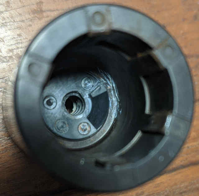

  11. longinthetooth
    longinthetooth Junior Member
    Aug 12, 2020
    Fremantle Western Australia
    Interesting how the EGR valve topics just keep coming up!
    I too am curious about the actual valve, as it seems to me the real issues is the valve not seating properly, which then leads to further carbon build up on and around the valve, and hence worsening the seating and valve operation.
    I wondered if a regular maintenance task might be to check the valve operation and make sure it is returning to the closed position, maybe even rotating it to see if that of itself, improves its seating.
    When I removed the plastic cover, the magnet rotated of its own accord. So not sure if it needs to be rotated before re-assembly, and if so which way?

  15. ChapmanF
    28,040
    18,547
    Because of the way they keep coming up, there keep being questions that have already been answered in older ones.
    The engine can run poorly either because of EGR flowing when it isn't wanted (such as at startup, idle, or full throttle), or inadequate or uneven EGR flow when it is wanted (mostly mid-loads), and both kinds of issue get reported here and of course they're opposite issues with different sets of causes, so it's probably overly simplistic to try to say what's "the real issue". There are some known issues it's worth knowing about, and the kinds of symptoms they cause.
    There's a spring in there, so yes, it'll do that.
    Rotating it clockwise (viewed from above) is the direction that pulls the valve pintle closed. When it rotates counterclockwise (and the stator/housing is bolted down), that pushes the pintle open. (Of course, when the stator is removed, rotating the rotor counterclockwise just unscrews it off the pintle.)
    You shouldn't really have to be too obsessive about how you assemble it, because the control strategy explained in the repair manual is that the ECM is just always sending steps in the clockwise direction at all times when it doesn't want EGR. So even if the rotor hasn't started out at its fully-closed stop position, it'll get there in a matter of seconds.
    But somebody did recently report having hard starting after reassembling the valve, which got easier after re-reassembling it, working a little harder to keep the rotor spun down to that point. I don't have a great explanation, but someone did report that.
    If you have the valve completely out of the car, then after reassembling it you'll see the pintle a little bit open, and just give it a hard shove closed with your thumb, and you'll hear and feel the rotor spinning inside and now you'll know it's closed. That has the added benefit of confirming for you that nothing is jammed up. But you can't do that if the valve's attached to the cooler.
    You don't really want to play with the surplus movement. Yes, when the rotor is lowest, fully clockwise, that's the fully closed position, and there is a positive stop molded into the rotor to make sure it stops exactly there.
    One of the issues we know about for this valve is that the rotor can end up with a track mashed all the way through that ski-jump stop, and then it doesn't stop at the fully-closed position, but goes past it. In essence, that gives you the "surplus movement" you're thinking of, but it turns out not to be a good thing.
    The reason it's not a good thing is this: the way the ECM finds "closed" is it just sends pulses in that direction all the time, and trusts the rotor will eventually hit that stop, and that's where closed is.
    When the ECM wants open, it just counts the step pulses it sends in the other direction.
    So if the ski jump is mashed and the rotor went a bunch of steps past closed, then whenever the ECM wants the valve open, it'll be a bunch of steps short of the correct opening.
