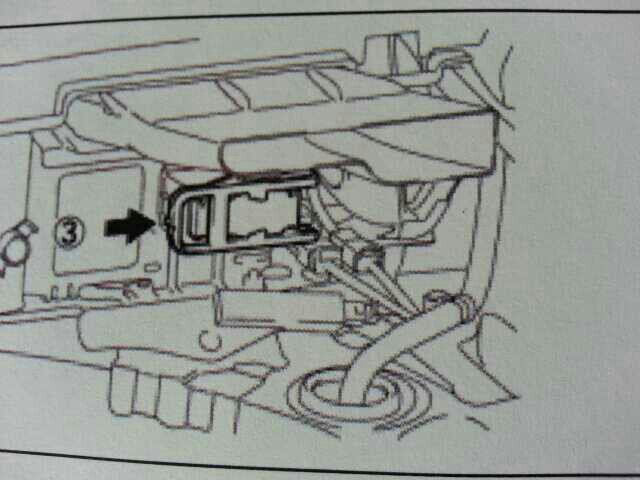

  9. jzchen
    jzchen Newbie!
    Apr 9, 2012
    3,298
    1,010
    Arcadia, CA
    Sorry to beleager the point
    1 push in
    2 rotate from pointing to you (rear) to pointing to the left
    3 slide handle to the right
    SCH-R530M ?
    #9 jzchen, Aug 3, 2014

    Jzchen, beleager all you want, stupid me was forgetting that last little slide downward after flipping the lever. The car now starts and sounds immensely better than it did before surgery. Thank you for that. What kept throwing me off was the "horizontal" last slide, mine is mounted so it slides downward on the last part.

    Sorry if I was reluctant to show the pic. TIS is particular about sharing. I had a feeling, as I went through this issue last night. I got to bed past 3:30 am and only got about 3 hours of sleep!
