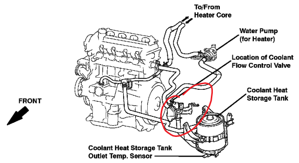

    Thanks @Tombukt2 and @SFO ! After some additional diagnosis, and blind feeling/paper towel for wet spots, it turned out to be a bad coolant control flow valve. Thankfully it’s the same repair I’ve performed previously, but certainly annoying for it to fail after only 50k miles. Went with a genuine Toyota part this round (rather than Rock Auto OEM equivalent), and I should be covered until we hopefully trade up for a 2023 Highlander Hybrid for our growing family.
