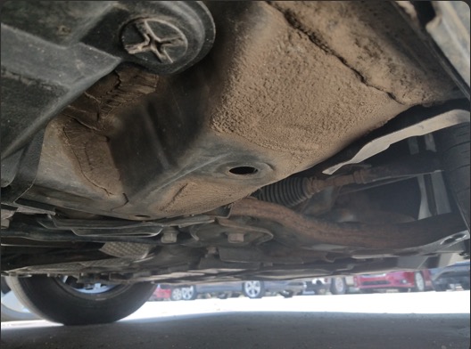

    I'm not sure what i'm looking at above here - is this dirt, or rust and corrosion?
    Might be buying soon. Car's a 2012 with 45k miles - Toyota dealer's asking $13.8k for (Prius 4). It's a car from upstate NY which has salt/water corrosion issues in the winter. Car is otherwise clean inside (the driver foot area has a salt stain but otherwise car is clean for its age), and owner regularly serviced it.
    Should I pass on this car? I intend to keep it for as many years possible.

    looks like some kind of undercarriage coating, but i can't be sure from the pic. what does it feel like?
    it also looks like some of the aero covers are missing. ask them to include in the purchase price.
    prius doesn't have a ton of rust problems, although things can look rusty

    Can't say since I'm not there - there was some mention of undercoat protection possibly done, but don't know.

    Is this something to consider too? I don't know what these parts are. Thanks in advance.

    no, the entire underbody has plastic covers for aerodynamics. there is an oil flap that often breaks, and sometimes, people just remove the whole front section for service, and never replace it.
    those circled sections don't look too unusual. see if you can find one to look at for comparison.
    is it a one owner, always registered in ny?
    Haschwalt likes this.

    Yes one owner always registerd in NY. Always serviced at same Toyota. Very low milage. The big area that we mentioned before is dirt not undercarriage protection.
    How much would those plastic covers cost for aerodynamics ball park?

    Typically a car that has been treated with “Fluid Film” will collect dust like this. Although the dust looks unsightly, the “FluidFilm” is probably the best solution for rust preventative maintenance. It’s an oily product so you can expect a build up of road film and dust. Your picture seems to look like this is the case.
    A good test would be to rub your finger across a section of the undercarriage. If your finger comes up with an oily dirt mixture you should be fine.

    Great info! Should you leave that dirt on there then if this is the case? Or can/should you remove it?

    Yeah, it looks like under body coating. If you can touch the part with you finger and comes off it is likely something similar to Fluid Film mentioned above.

    Let sleeping dogs lie.

    not sure on the costs, depends on what is missing. probably a few hundred.

    If it is Fluid Film, then they do recommend annual "touch-up" coating application. It is not permanent like some other undercover coating that hardens like plastic.

    So Toyota dealer said that, "There are a few of those undercovers listed on the illustrated parts breakdown that are not applicable for the VIN ."
    It's a Prius 4 Trim with solar roof option.
    Thoughts? Is he incorrect?

    BTW, the rubberized undercoatings that are used are death on the undercarriage of cars that are driven in the “ Rust Belt”. These types of coatings promote rust damage by trapping road salts an moisture in between the metal and the coating. By all means, stay away from this type of product.

    Why does the 4 trim miss the undercarriage "aero" panels but the other trims don't? And sorry if I misunderstood, but are you saying this car may have a rubberized undercoating or just in general?

    There is the possibility that the PO removed them because on dirt roads. Those underpanels can collect copious amounts of brine saturated dirt.
    It doesn’t appear that the car has rubberized undercoat. If that was the case, you would have no doubt because the car would in all likelihood be a rusted, see-through rust bucket.

    Dealer said, "We use auto armor for our undercoating. It is a petroleum based product that is only applied once. It dries to a slightly tacky consistancy." Is this the same rubber stuff you were talking about?
    The car's a good deal/price wise - clean, and besides that surface rust on 2 componentss, and the missing aero panels (if anyone can chime in on whether or not this was a part of the Prius 4), car seems good I think. I'm close to buying it in the next few days.
